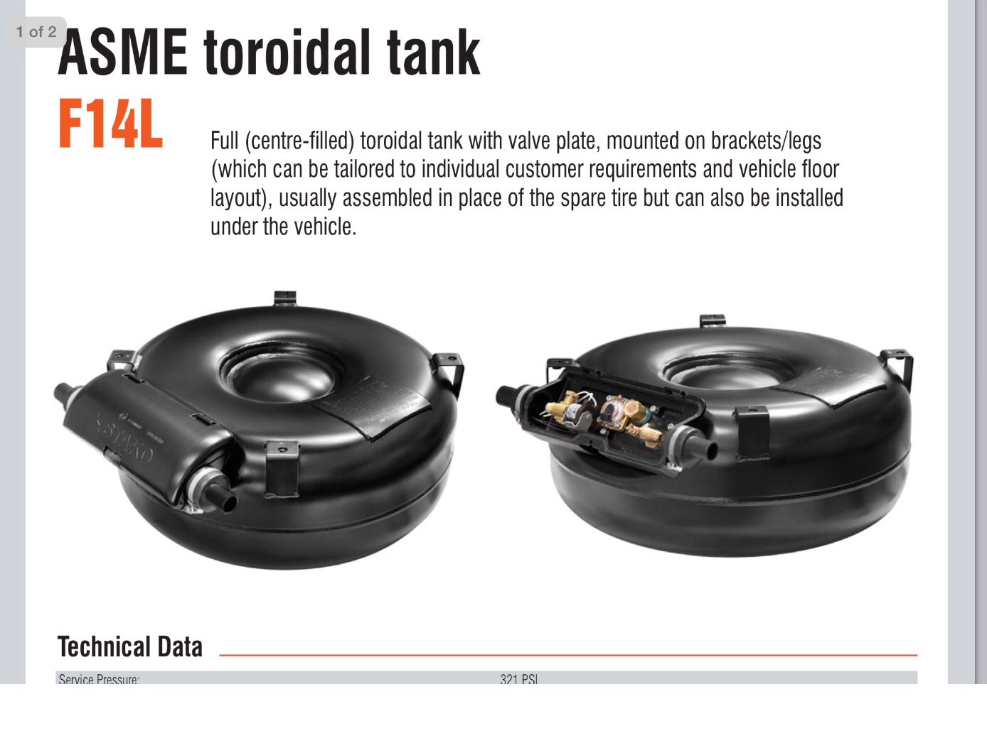

check out this new propane tank. 26 gallons.
