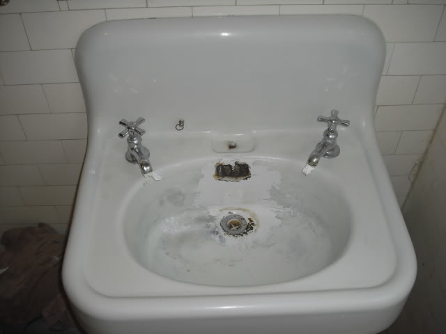

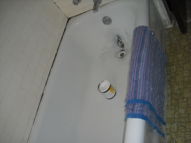

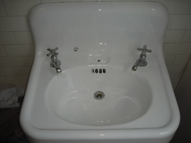

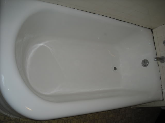

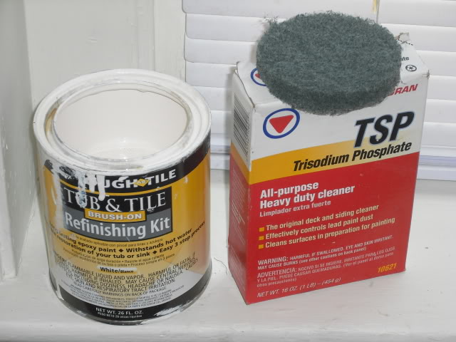

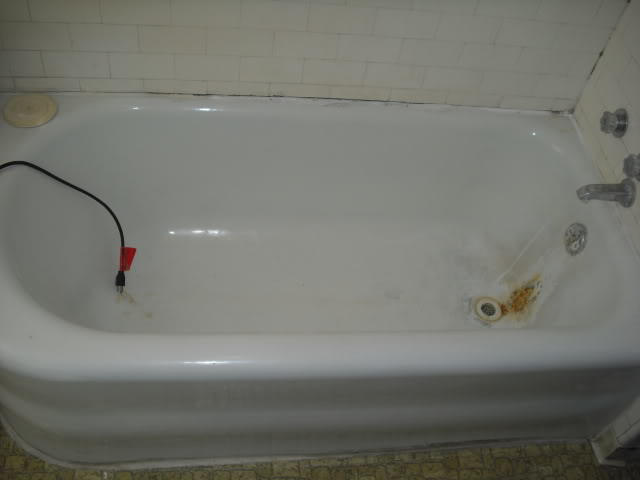

Another $450 yesterday for a tub and sink. Took 3 hours, over 2 of those were in the prep. I cannot stress the prep enough on this work. These two had been glazed one time previously and most had already come off. I used a window razor to remove the rest. Be sure to place a towel on the edge of the tub after cleaning, you do NOT want your skin to come in contact with the cleaned tub, as the epoxy will react with the oils from your body. I am going back Monday to give these another coat, and caulk (about 1 hour) and do another tub on the next floor.

The can says "brush on"is that how you are applying it?Is it as simple as cleaning very well then recoating?Where do you buy the coating?Makes a hell of a difference.
