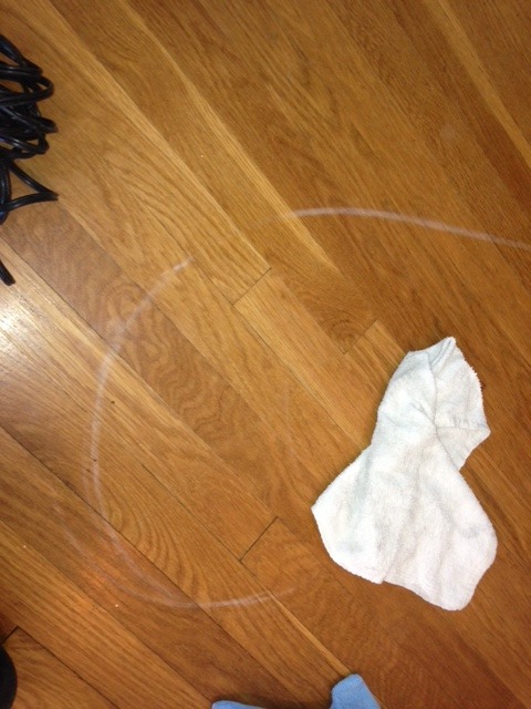

A couple weeks back I posted about an issue I had with our hose leaving a "C" ring on a hard wood floor. The floor did not show apparent damage but there was a "haze" in the finish on the wood. When I ask them what they had used on it they told me Muryphy's Oil Soap. I didn't get alot of suggestions here since no one had probably had that issue before so I just now made it back over to see what I could do to fix it. I took everything that I had with the intentions that I would do my best. I called a Furniture Medic that I met in a clients house about a year ago and they offered me a suggestion, and it WORKED!

The "Haze" ring left by solution hose

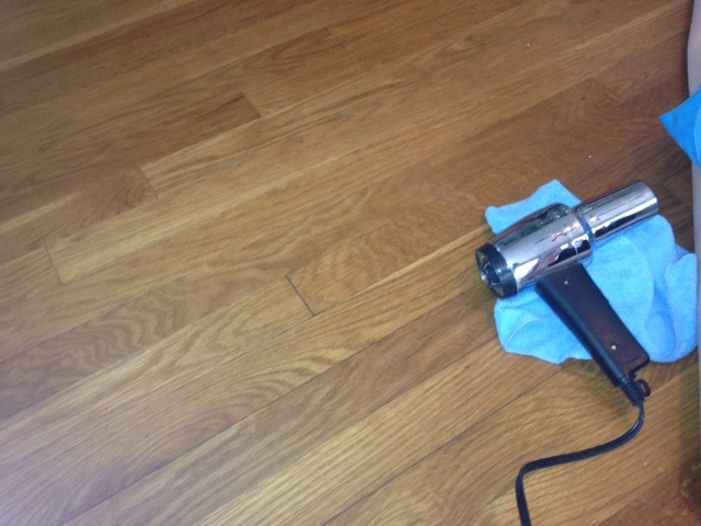

The Fix and REsult (Furniture Medic suggested that the haze was moisture that had been trapped under the coating) He said to try a hair dryer and uniformly dry back and forth until it evaporated the mositure. I used a old remote control model film application heat gun and it worked like a charm!

Seriously? No one here knew that? It's a pretty common problem for upholstery cleaning and exposed wood with an oiled or waxed finish.

At an association meeting last week a friend showed a picture of a cabinet that the customer said was damaged after cleaning was done there. The doors were foggy looking. I asked if the finish was wax and let him know he could fix it with a hair dryer. A couple other old-timers agreed. I guess some of us have seen wood that pre-dates modern hardened finishes, but wax and oiled finishes are coming back so should probably be included in hard surface training again.
