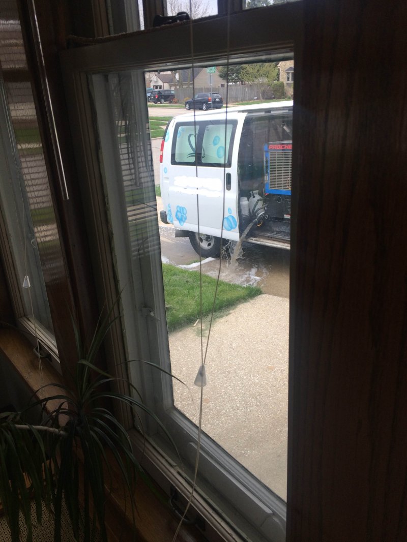

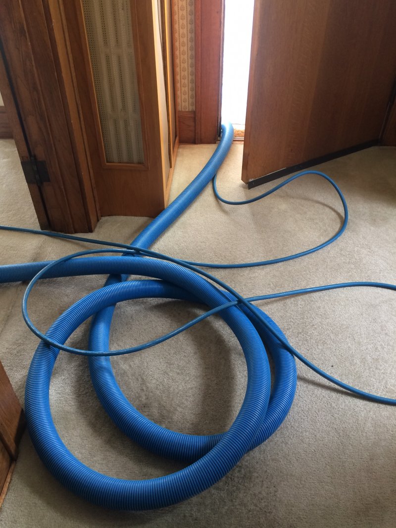

Shows up on time; good lad. I'm equally amused and horrified at hoses being run in my door for the first time. True that I don't appreciate them being dragged along my old woodwork though.
View attachment 71861 I am surprised by the truck stink--something I'd never considered or experienced before. He says the things all cleaners learn to say, like "be careful going from the carpet into the kitchen as it may be slippery." I find this adorable for some reason, but also understand it kinda secretly might mean "get out of here lady I'm working." I split and let him work, taking a few surreptitious pictures on my way to the garage to hang out with my mess there for a while.

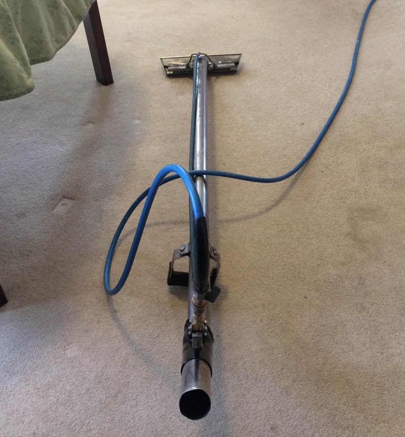

View attachment 71859 Some kind of cleaning tool. :)

He's outside packing up when I hear water running. I go to the window and I can't believe it but he is dumping right in my driveway. And my street drains right in to Lake Michigan; extra not cool. And now my driveway is going to smell?!
