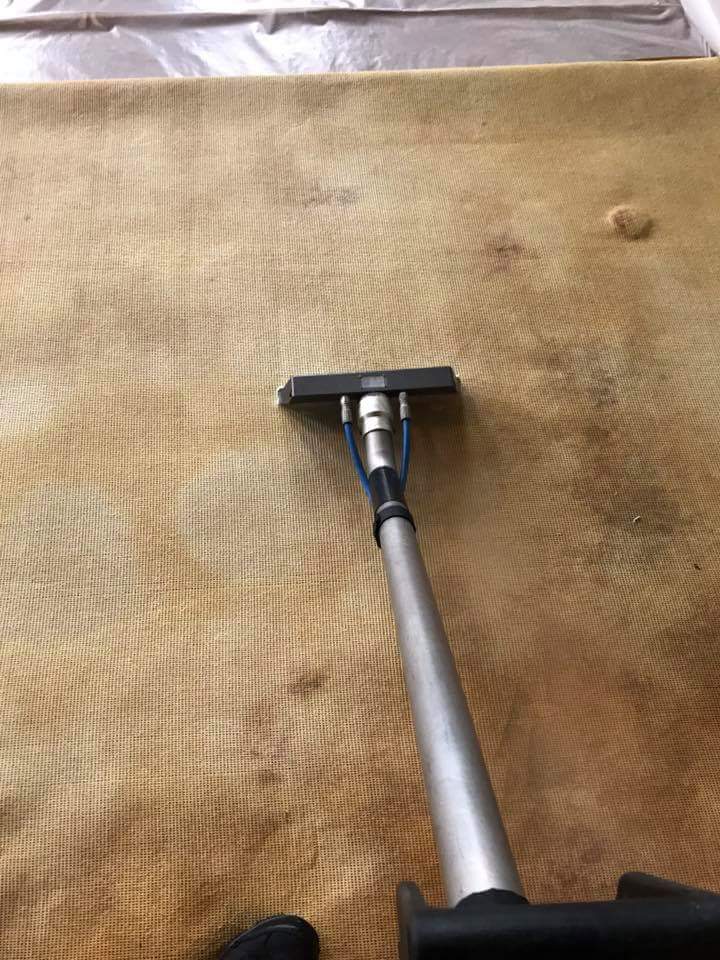

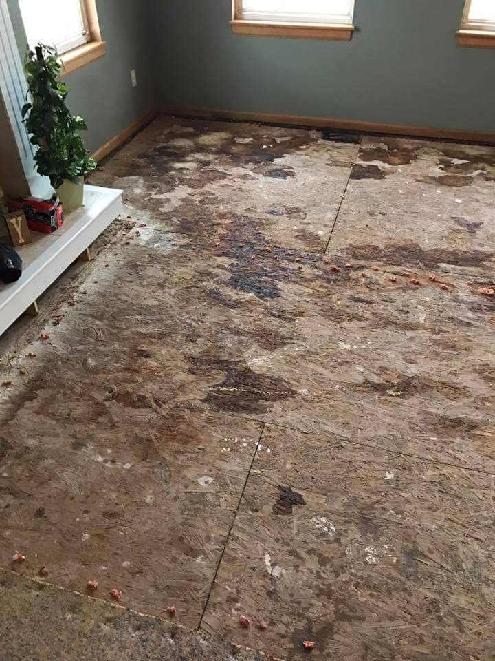

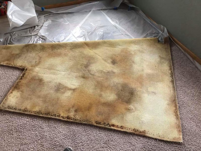

When I see guys bragging on making $1-$4 a foot offering pet urine treatment, removal services I just erks the F out of me these days..
The whole lifting of the carpet and verbiage needed to convince them that this is the way to go is something I refuse to, or let my guys do.
We're a lay it down thick, RE and wait for the animal to die type moral company.
But that's just me.
If you dont advertise this service, they won't call you..
Saw these on FB last night...:dejection:

I personally don't like to wand clean the back of the carpet like that. I have done it a couple times but each time I did it the whole carpet fell apart. I would much rather leave in place and inject a bacteria into the backing or if it is a really bad area, flush with a water claw in place. Course there are a lot of times the carpet should be replaced.

If the pet will still be occupying the space we just treat heavily even water clawing some areas and speed drying the area, advising them to call us to permantly fix the area once the pet no longer will inhabit the area for what ever reason.
Once pet is gone, we will pull pad address sub floor ensuring it it dry, lay down new pad, spray our pee eater, then flush the carpet, speed dry it.
Don't forget to spray and wipe down baseboards and doors where colateral spraying occurred.
You must charge very well for this service as it does take a while and in most cases requires a return visit.
I will add, we would not of reused that piece if carpet as it was pretty bad, recommend replacing it if not get a signature.

Why would anyone want to salvage that?
I might pull the corner back to show the Owner the extent of the damage, then I would tell them to be sure and pay the extra for disposal when you order the new carpet.

I would not have cleaned that!

I wonder how many graduates of the dump and claw school pay attention to plywood joints...

I'd suggest some sheet vinyl for that room in the picture.. Pretty gross..:dejection:
With all this pet pad and membrane pad being sold that may start becoming less of a concern. Although we are finding that wicking is a bigger problem in homes with this type of pad.
Although, there are still seams that water may find...
