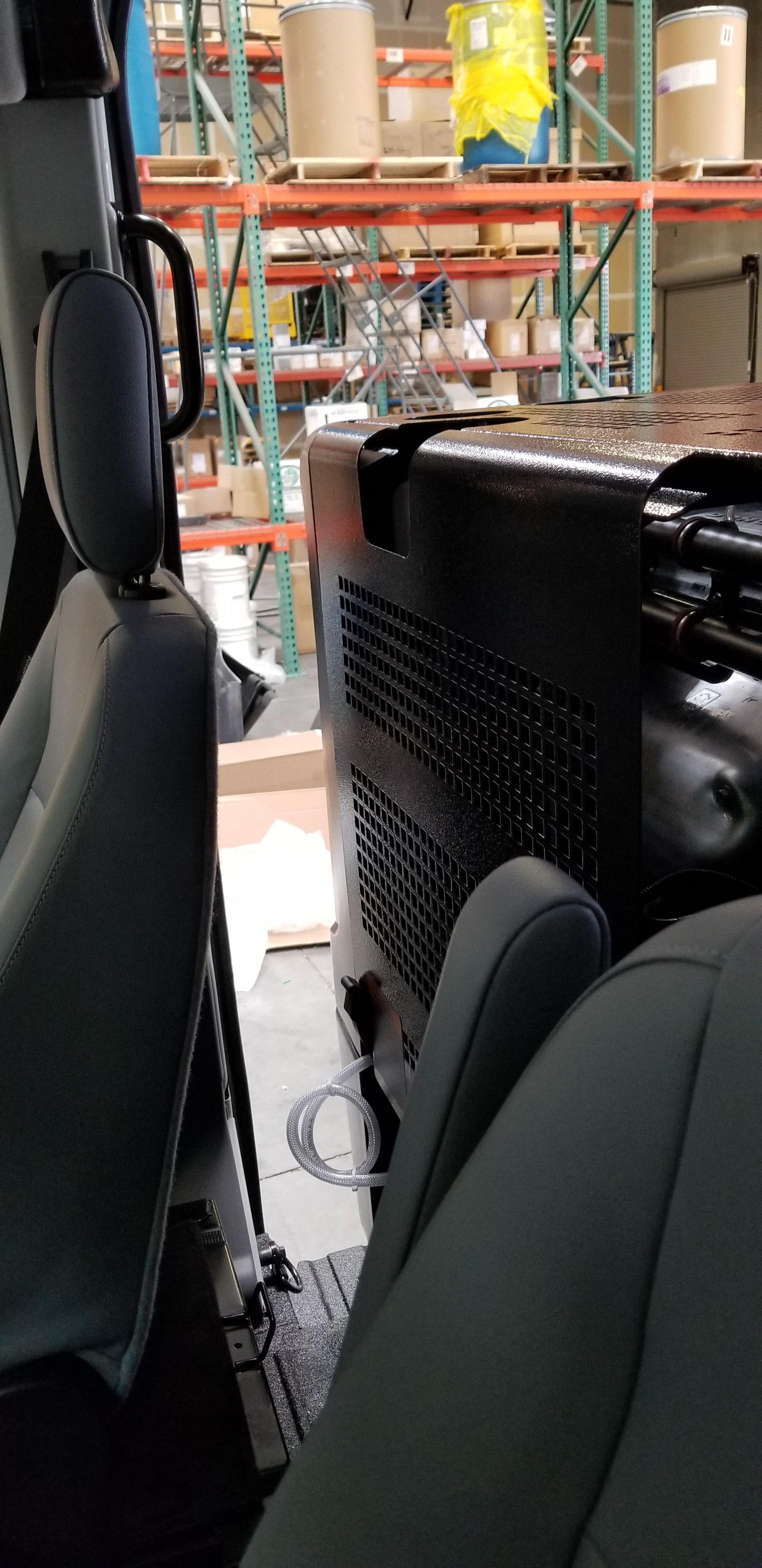

Unblock the side door.
Make accessible space more usable.

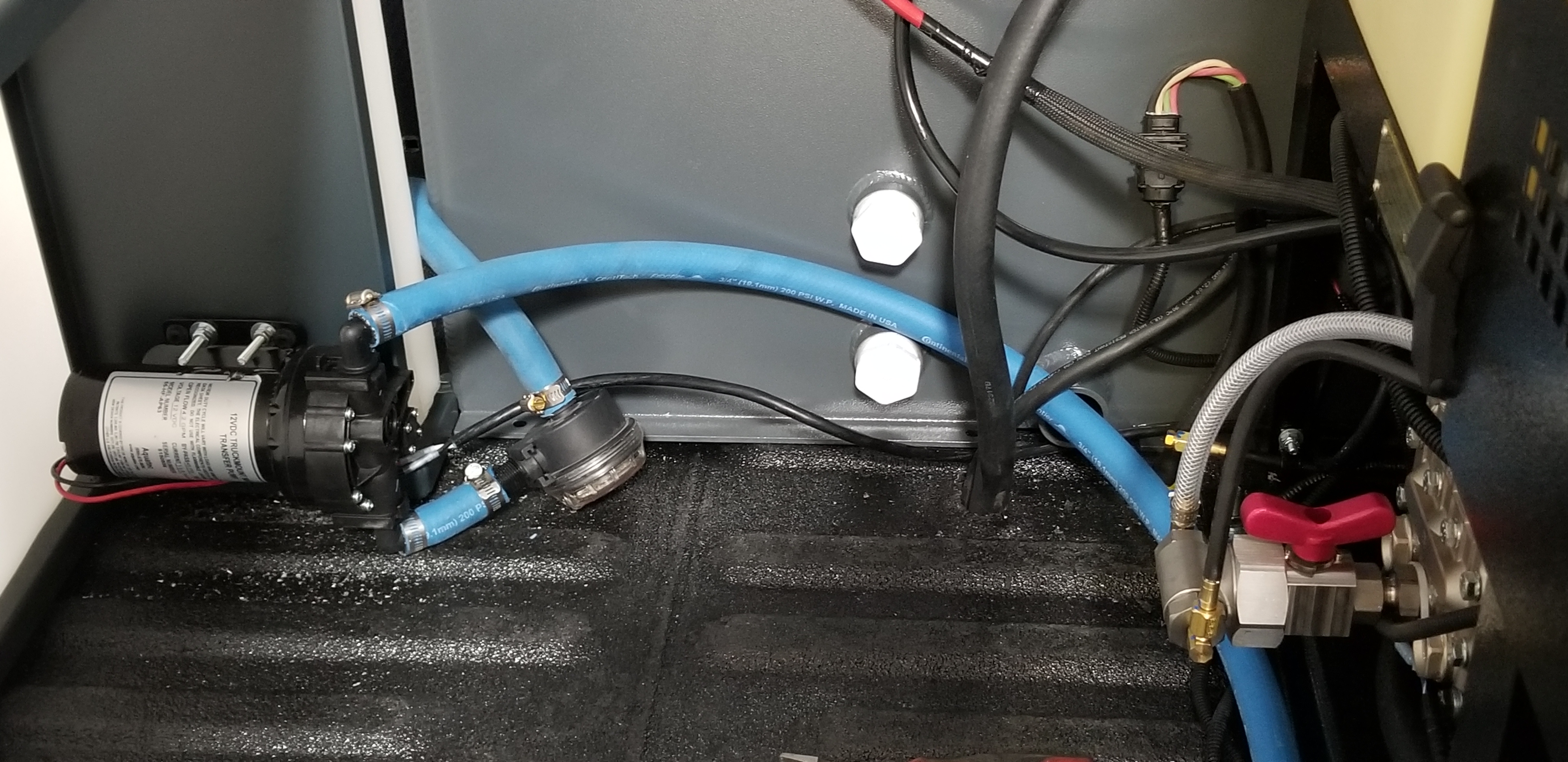

Eliminate transfer pump.
No I wouldn't "hang the tank from the roof", but it would not be difficult to mount.
117,349
7,040
You can eliminate the transfer pump with elevating the fresh water tank. Simply follow the same plumbing diagram the V has.

What size of fresh water tank did you get? Nice use of the wheel well hole.
