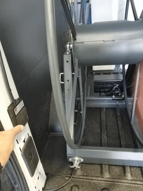

My new Prochem Everest

So what does that hose reel cost nowadays? Looks like the one I have. Wait til you have to replace the motor.

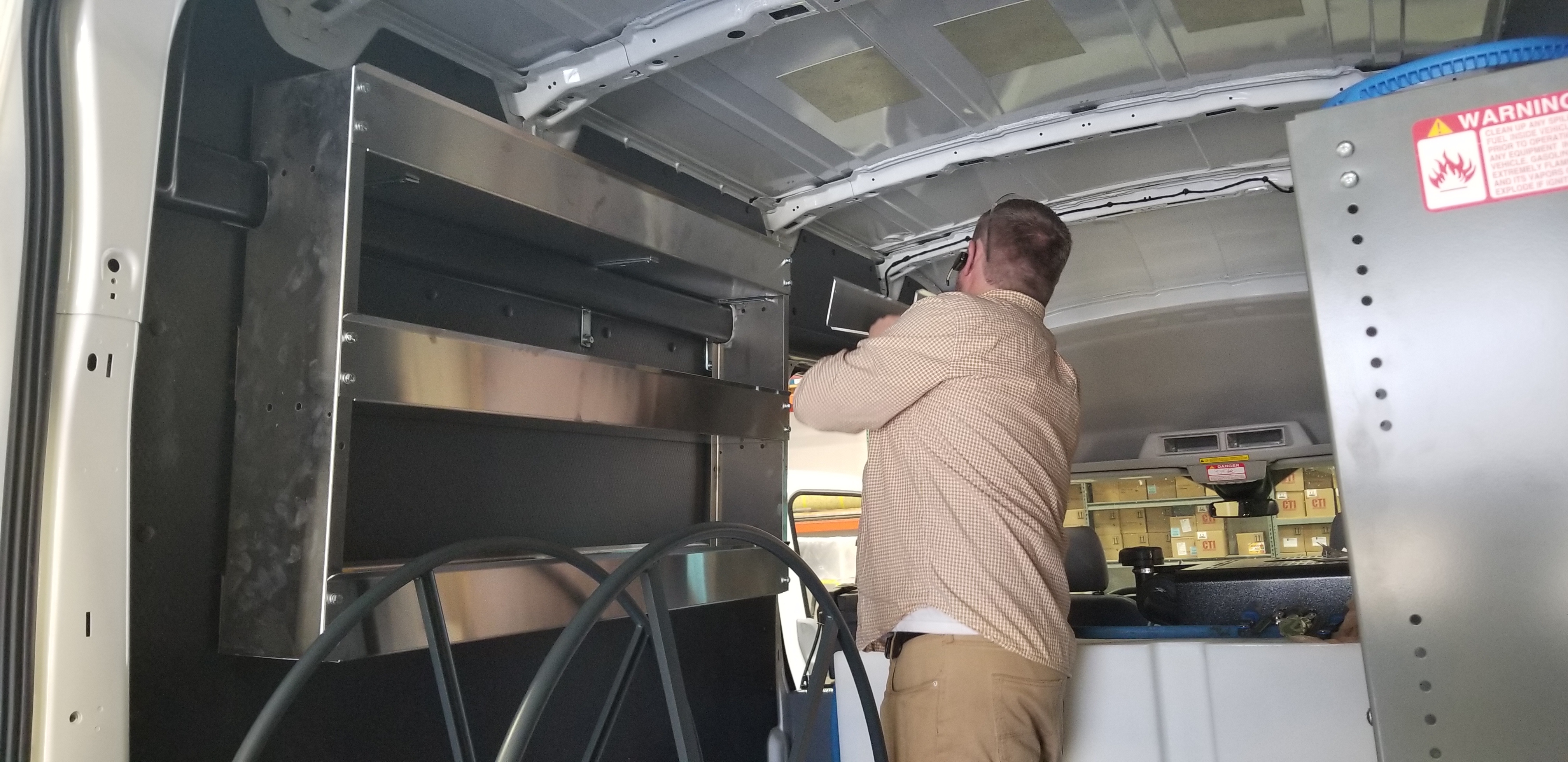

I'd mount it in empty space above the machine/ waste tank, leaving floor open. ...and no transfer pump.

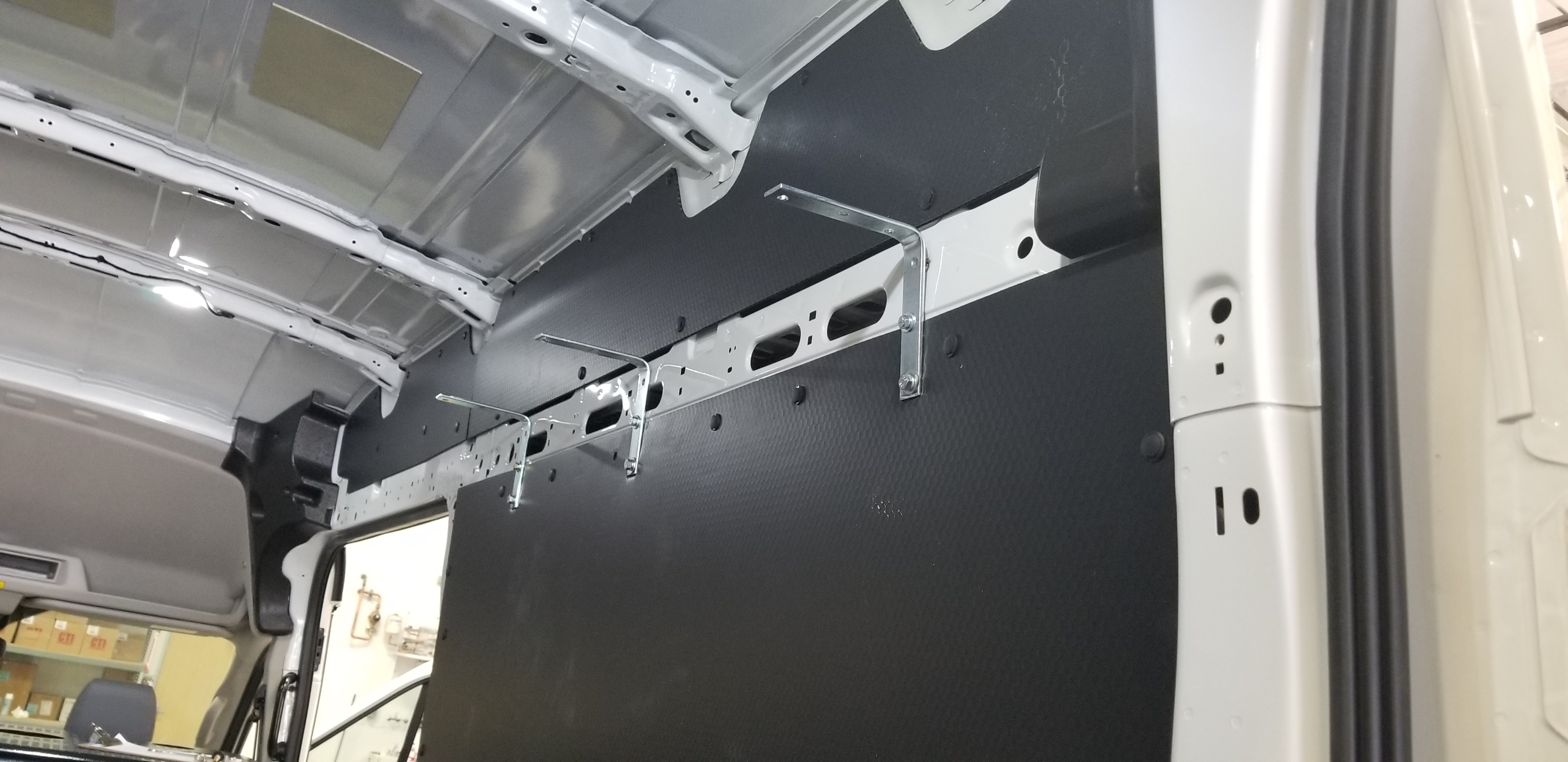

Still dying to know how you plan on suspending 900 pounds from that thin roof..

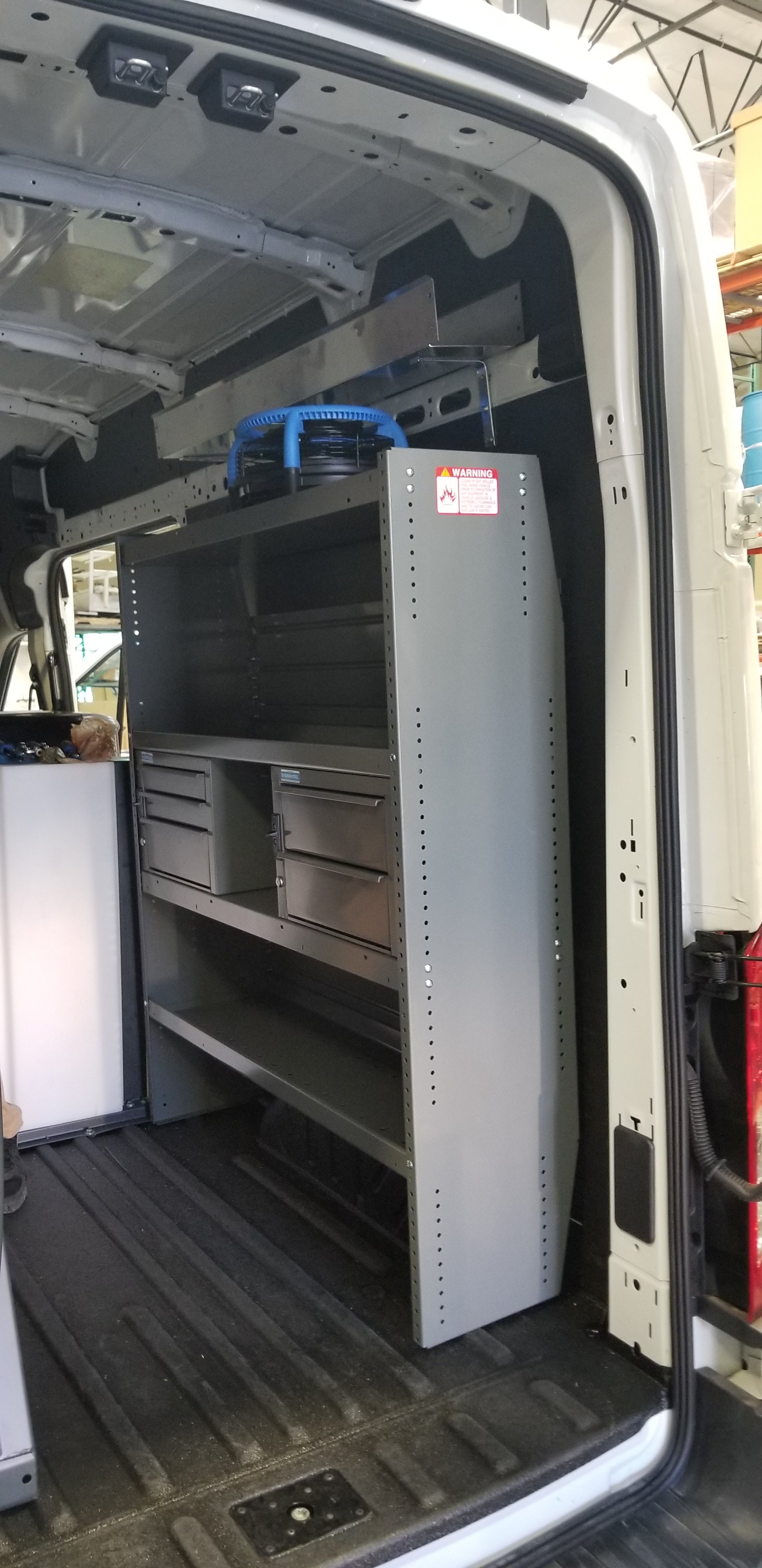

I have 2x100 gallon waste tanks and a 125 gallon fresh tank. No room for a transfer pump. 38" x 96" open center floor in the back for buffers and stuff. Lots of shelves. Will do pix.

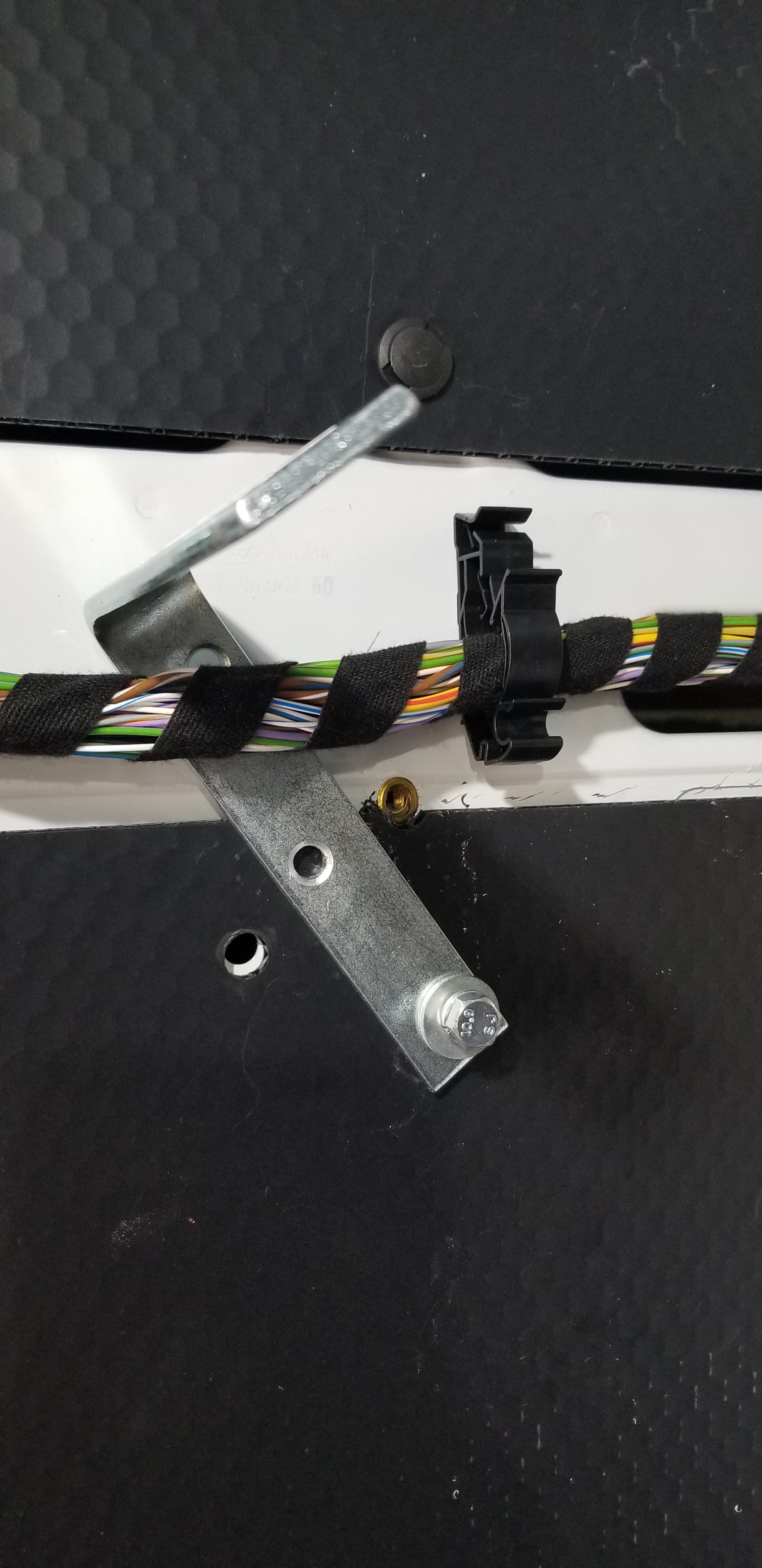

Wrap a bracket around two of the crossover top rails, and the vertical rails going down, at least four points. Add at least one support down to the floor, depending on where floor supports are located, where it won't block other access needs.
Poly tank would slide into the platform empty and be strapped to it with the factory straps.

Gotta figure employees driving it and being safe safe safe, one thing if he was driving it only!
