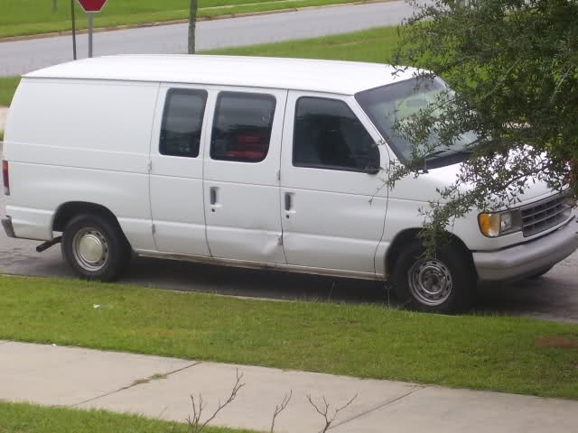

Ok, that is an old 1500 I believe, with a 36 roots( the blower size),and they went with a muffler instead of the silencer,so put that thing aside till you need it some day. 5000, did that include the van?,if so, then it wasnt that bad of a deal, and I bet that motor is cast iron so it can be rebuilt a few times.Just get some training and go make a few dollars.
Kevin
yeah that included the van its a 1994 Ford E-150... no other dents besides the one in the door in this pic...

That's a big Stoddard silencer, worth a couple hundred dollars by itself. However the nature of silencers dictates that smaller silencers reduce noise better than larger ones. The red one in the pix is very mis-matched to that 36 blower. Was probably a disappointment to the buyer at the time. It would rock on a 47 or larger, ideal for a 56.
