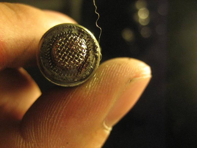

after a couple of hours of investigating the fix only took twenty minutes. it ends up that the pto solenoids inline filter/strainer was clogged with debris from the current tranny rebuild ( i am guessing). i didnt know it but in all of the stuff i got with my two v s i had one of these in a box. the install took about twenty minutes and now the v is back up and running.

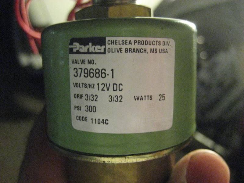

i think it was the filter or inline screen was clogged but i ended up replaceing the whole thing.

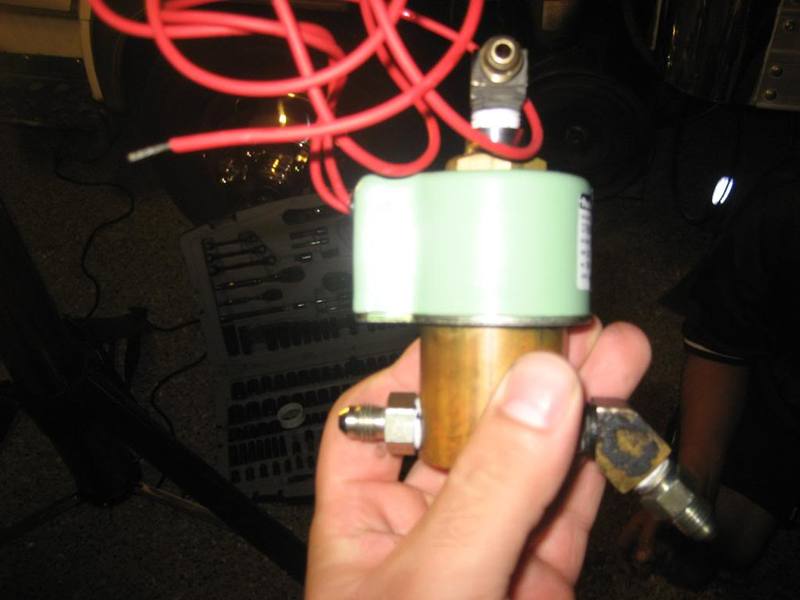

this is the solenoid i installed.
this is the used inline filters/strainer.

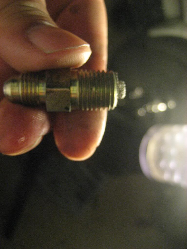

this is the new inlne filter strainer.
filter side on new strainer
complete pto solenoid assemlby ready to install.

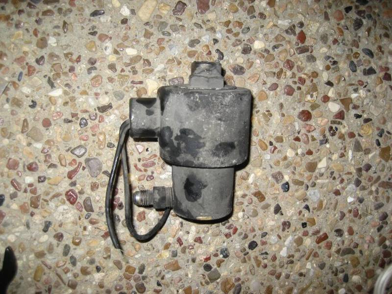

this what the original looked like and it was a peterpaul electromincs 06050 solenoid.
