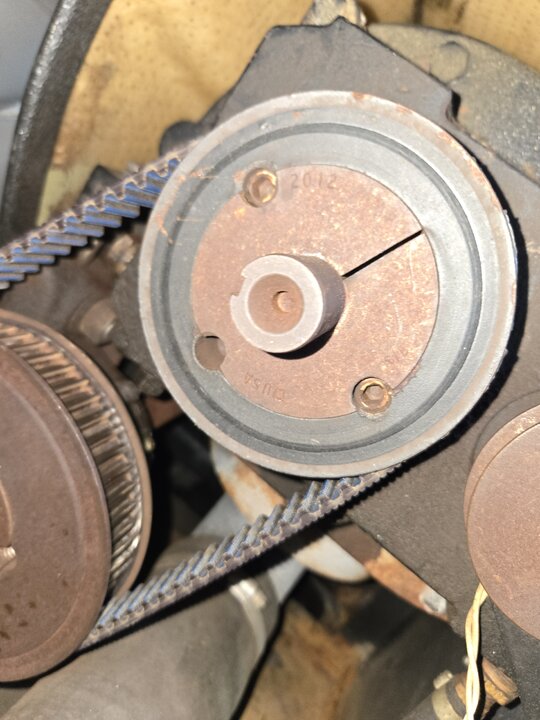

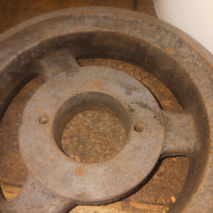

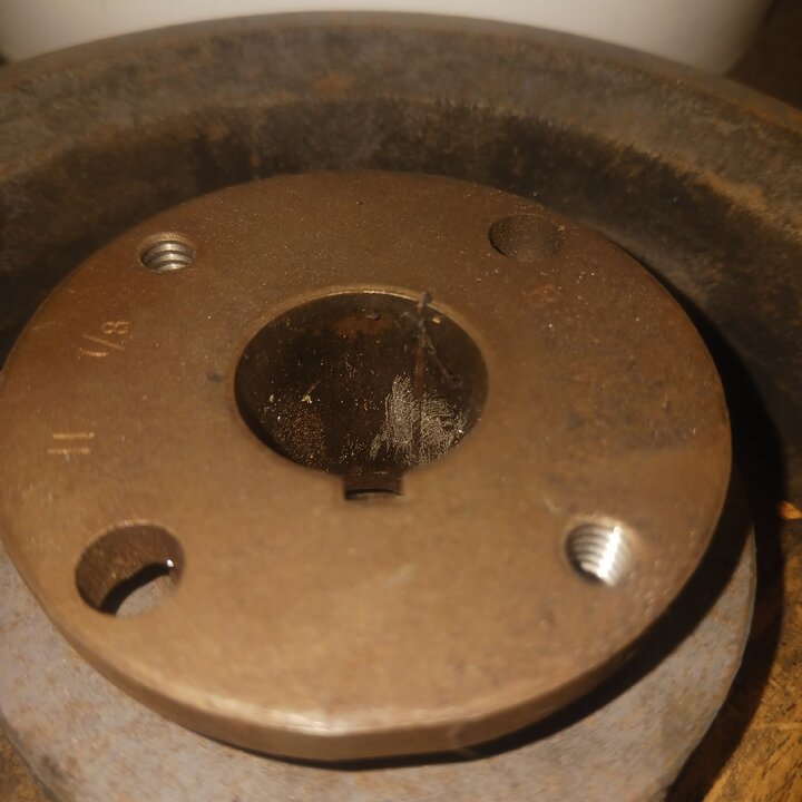

I take it you got the old broken bolt out ok? I need better pics of the pulley and brand name?? All my machines have browning pulleys with them the 2 bolts that tighten are used to to remove ( open holes to tighten threded to remove )

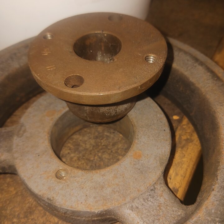

View attachment 131697 View attachment 131698 View attachment 131699
I did get the sheared bolt out! I propped the blower up with a small bottle jack and the bolt came out pretty easily. Nice pulley, mine is stupid, there are 3 holes total, and only 1 hole to thread a grub screw in to pop the pulley off. If there were 2 removal holes on opposing sides I imagine going back and forth a few times would make it come off like a breeze.

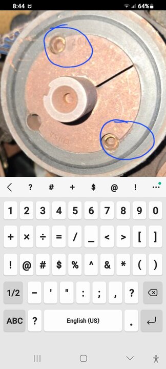

From the pictures It looks like there is 2 allen head screws holding it together??
If you can't get the pulley off, and you can't adjust the tension in enough to get the belt on. Can you loosen / remove mounting bracket bolts enough to get the belt on?? How about loosening the 4 jackshaft bolts and leave the blower stationary and move the driveshaft in enough to get the belt on. If there's not enough threds on the driveshaft bolts to allow it to move enough to install the belt , maybe remove the bolts 1 at a time and temporarily replace with longer ones to keep everything together while replacing the belt then tighten up and reinstall the original bolts one at a time ???now another thought are you attempting these repairs with the driver and passenger seats still in the van???
Great tips on moving the driveshaft, I didn't have to do that this time since I got the pulley off but I think I will certainly go that route when I need to remove the blower belt in the future. I didn't think to remove the seat! Seems like I don't think enough :)

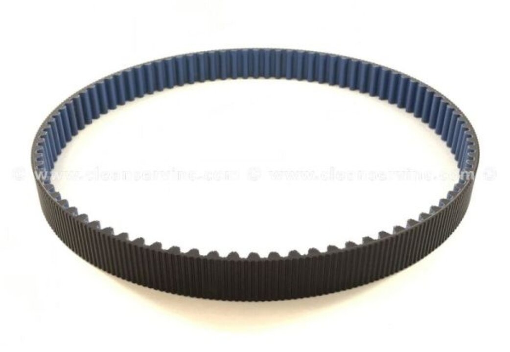

I had a feeling a perfect fit was important. I actually drove to the hardware store and bought an appropriate long allen head socket for that pulley. My metric set was too wiggly. After I fixed the blower mounting bolt I realized I need to put the pulley and belt back on separate because the pulley and bushing need to line up perfect and be seated on the shaft perfectly. I ended up loosening the pillow blocks and did your recommended trick using longer bolts to get enough movement on the lower pulley to put the belt on.
I got it all fixed up! Changed the blower oil and removed the salsa heat exchanger and soaked it degreaser and cleaned it out while I had the driver seat out. At first the blower belt was too tight, but it was quiet when I ran it. Then I overcompensated and the belt was too loose and began squealing when I ran it. Then read the manual again and learned the belt needs 1/64" deflection per 1" of span, so a little less than 1/4" deflection on my setup. I think I got it right on the last time. Now it's quiet and isn't scary tight.

Any chance this thing will now run trouble free for 1000 hours?
I don't know the blower belt should if the gear belt is aligned and tensioned properly you should get years of service outa it. As far as the rest of the machine goes, i don't know haven't seen much of it but once you get the power pack dialed in the rest is just hoses and fittings.does your machine have a chemical pump ?

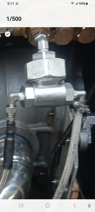

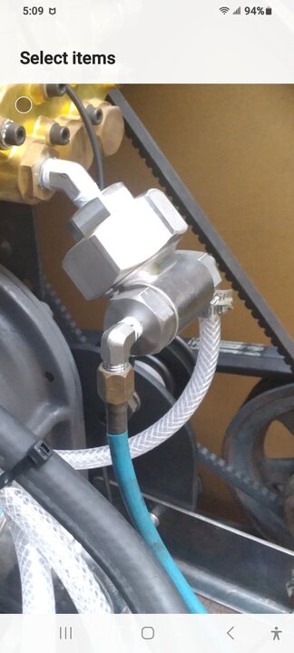

Its a little pulse pump . It would be mounted on one of the valve caps on your main pressure pump it would look something like this
Screenshot_20250712_170927_Gallery.jpg Screenshot_20250712_171114_Gallery.jpg

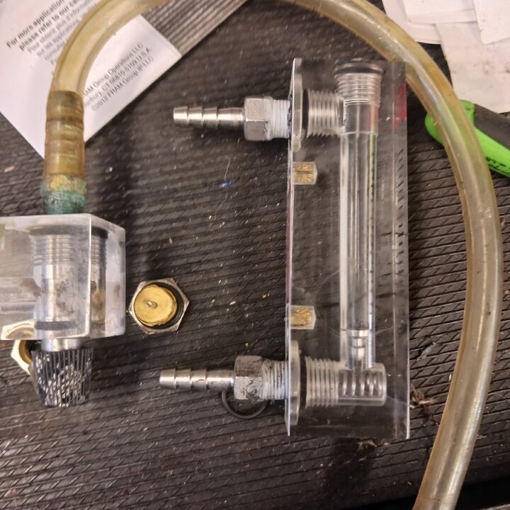

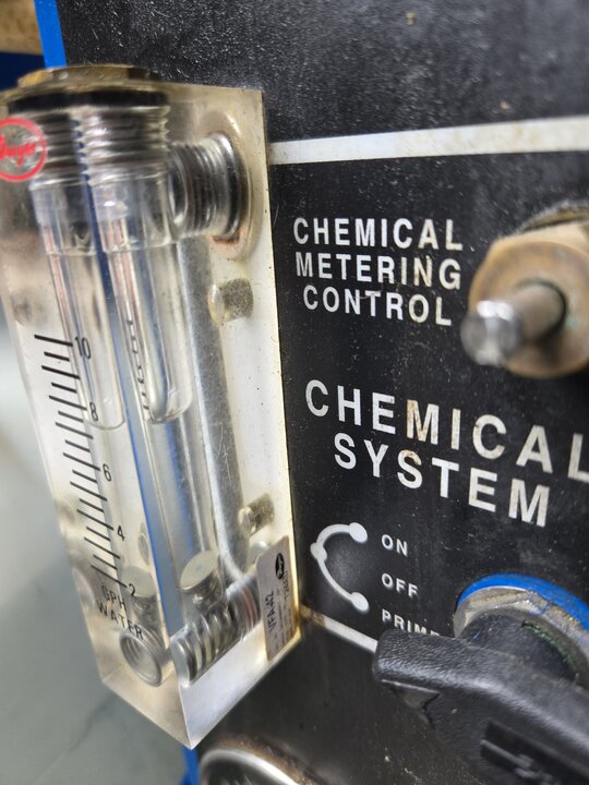

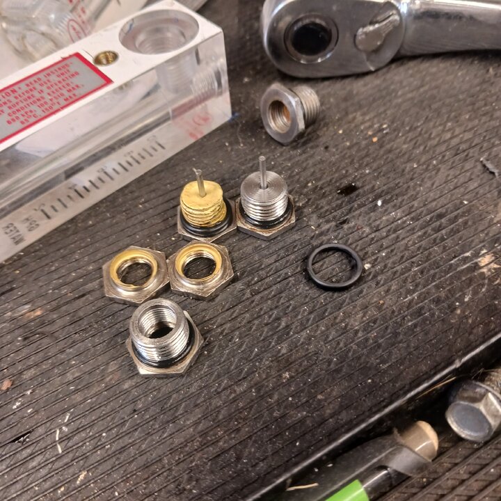

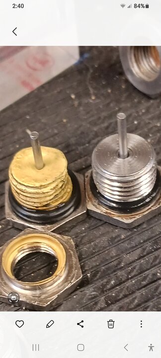

If you have a chemical pump your chemical meter probably has brass fittings and depending on the chemicals you use they tend to deteriorate quite rapidly. The dwyer meters used on machines that use starvation to supply chemicals are all stainless. The way I found this out was all my business life ive had machines that used starvation to feed chemicals. (They have a flow adjustment knob at the bottom of the meter) when i retro fitted frankinstien with a chemical pump i bought the proper dwyer meter and it lasted only 900 hours before giving me problems. The way that i solved it was to take fittings from a pile of old meters that were all stainless and swap out the parts. I have a bunch of um if you'd like to do the same to your meter. I don't have any extra â…›pipe to hose fittings to connect it up but their easy to find on ebay Amazon etc.etc.
  • Love
Reactions: Bryce C

I'd love that Dwain, very kind offer thanks bud! Yea I think I have the same setup you took in the pic. I'll confirm tomorrow. Thanks for heads up about the weak point in the system too, and a lasting solution!

I think we have the same chemical meter Dwain.

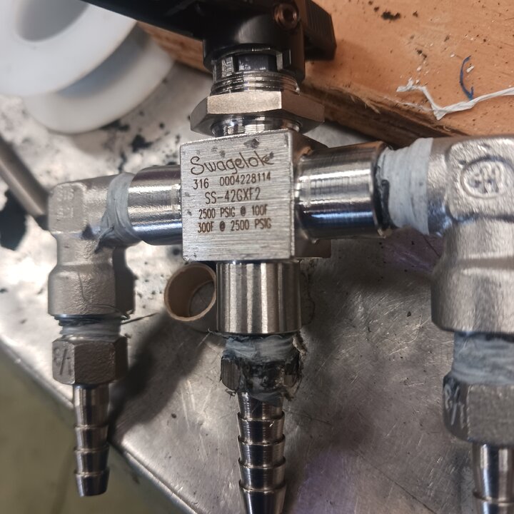

Yes, youll find the top piece and the 2 back pieces are brass dm me your address and ill send you the stainless versions. If you unscrew the top piece it'll give you an idea of the overall condition of the other brass fittings. It appears that the valves for your meters are also brass. I wouldn't change um till necessary then change them out for swagelok brand stainless valves theyll last forever stay away from Chinese made valves here!
  • Love
Reactions: Bryce C

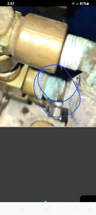

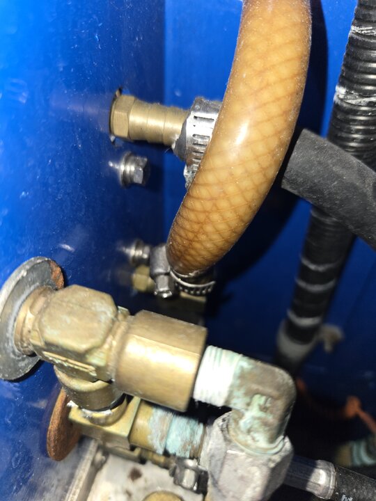

Except mine has a bunch of brass :(View attachment 131739
It also looks like you've already got a leak somewhere around here it doesn't take much to screw up the chemical pump system. There's also a packing seal adjustment on these 2 valves. If you use a small allen wrench to remove the handles, you can use an ignition wrench or mini crescent wrench to tighen the packing nut

Wow the difference between that threaded brass and stainless piece is incredible. The brass looks warped, worn, and pathetic. Thanks for pointing out the evidence of a leak. I'll check that packing seal adjustment when I have some downtime soon.
