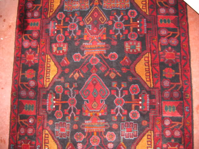

I recently cleaned some area rugs for a custy. 6 synthetics and 1 wool. He must have been happy with the work because now he dropped off a 4' x 17' Nahavand runner. Looks like it came from Iran and has wool / cotton construction.
I have never cleaned something like this before and am looking for suggestions. I'm not set up for much other than vacuuming and hwe.

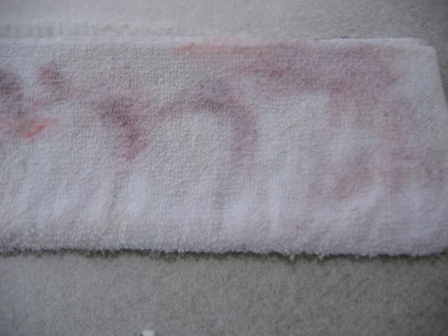

Even with a fairly neutral spotter the colors seem to release quiet easily

I have cleaned thousands of oriental rugs. I am not an expert on "names" but do know charicteristics.
Dry cleaning with OMS is clrearly the safest but least effective.
I would likely pre treat with acetic acid. I would consider hand shampooing (low ph using the suds (cold water)) then extracting with a stair/furniture tool for greater moisture removal. Post treat with acetic acid (or any low ph color stabilizing product). Laying face down helps reduce or eliminate color run in the drying.
I would not use hwe.
I cannot tell from photo if pile or flatweave? If pile could test clean an area on the back.
Restricted moisture (low ph) and accelerated drying should be safe and should provide the best outcome. But I would understand a cleaner not wanting to risk it and dry cleaning.
The brand products I am most familiar with are Dynasty shampoo (6.0ph) and Pros Choice color stablizer (2.5ph?)
Good luck.

Navahand? Hope you don't mean navaho. Navaho flat weeves are well known for their bleeding charcteristics. But with the rest of the set set here. I would mist some dye lock or dye set and then retest for bleeding. If all Fails you could do a dry wet dry method. Or do a coldwater extraction with a good acid side shampoo. If you use the Matrix products like listed below. Dynasty as acid side shampoo and use Royal mist as your acid side rinse. It also will help mitigate the bleeding. And of course dry flat. Another note: Not sure how you did your dye bleed test but alot of rugs, just like fabrics will tend to crock but will not always bleed. It kinda of looks liek you rubbed the towel rather than let it dweel with weight. Again I can't tell so I'm asking. If you did indead rub the towel on the rug, you still might be safe to carry out a wet extraction, I would just redo your test with the towel simply weighted down on the rug.

It kinda of looks like you rubbed the towel
You are right, total noob on this end.

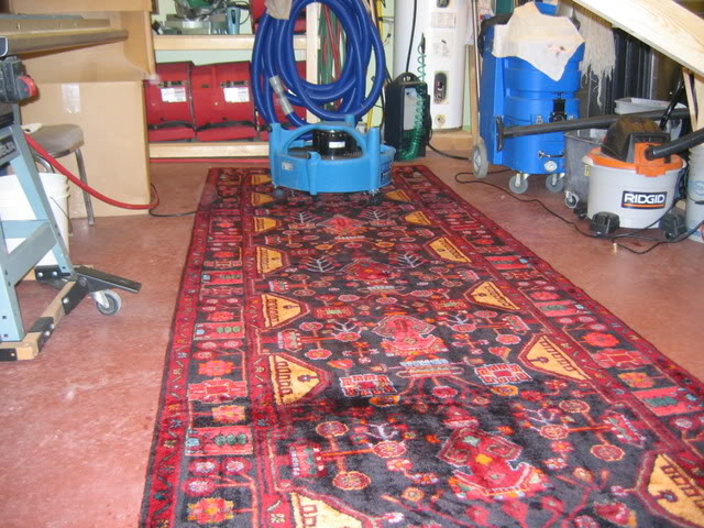

After I was unable to find a local "rug plant" decided to "get er done".
Vacuum back & Front
Light spray of dye stabilizer.
Even lighter mist of neutral natural fiber prespray.
Work in with horse hair brush.
Single pass low psi extraction with upholstery tool, cool water.
Force dry with Airpath.
Rug was dry 1/2 hour after cleaning.
More or less a "rinse the dirt off the top" cleaning.
