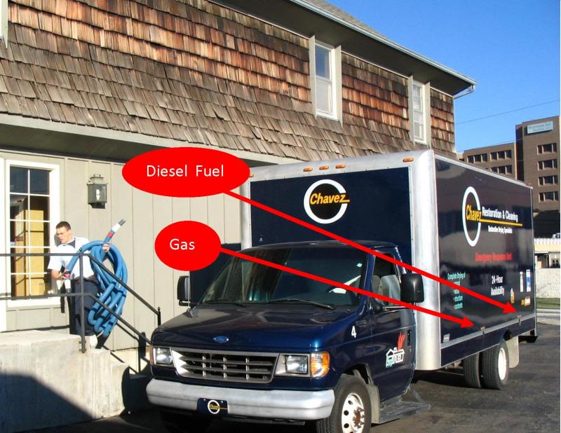

That is a 12 gallon tank. And the best way I have found to keep an open footprint is to install the reel on a stand over the wheel well, then the tank behind it, use the drivers side, as when you fill up, the vans nozzle is left. You can fill the van w diesel, pull up a little and fill the tank w gas.
I used 3/4 mdf x two on tops and sides of stands. Then to waterproof it, which is an absolute must, I used fiberglass resin on every surface, three thick coats, then carpeted it. When you install it, use angle iron on the inside legs underneath to floor, and inside to the cap. the top must be angle ironed to the wall as that stops if from failing on back and forth motion. There's a lot of weight up there.
