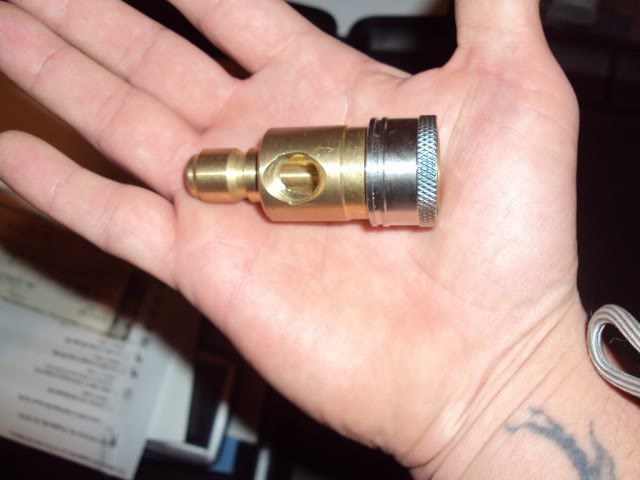

I can't remember where I got it but I had a quick connect with a port on it. Think it was a pressure gaugebut could be easily swapped. Might be worth checking the home depot pressure washer section:
or it would be easy enough to build one with a tee from the hardware store and a temp gauge from the auto store....similar to this:
