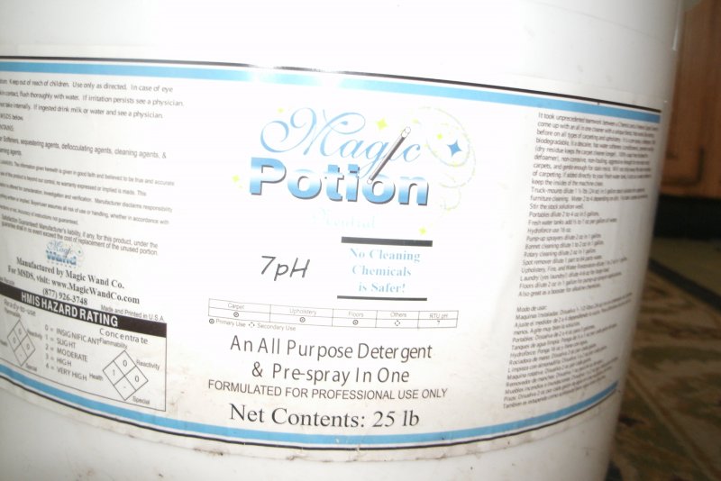

It will be a tall order to surpass the reigning champion, Magic Wand's Magic Potion with it's pH of 7 in a powder (Mikey Juice)
I don't put crap in my rinse water, just use FWR, but this stuff is excellent as a neutral prespray on upholstery, and it's a powder, which makes it very economical and convenient. Everyone should have this in their truck for wool carpets and upholstery.

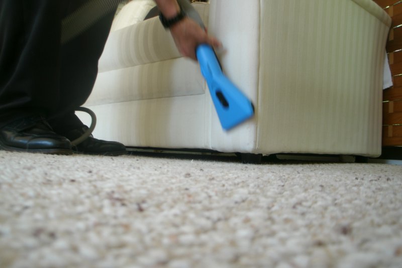

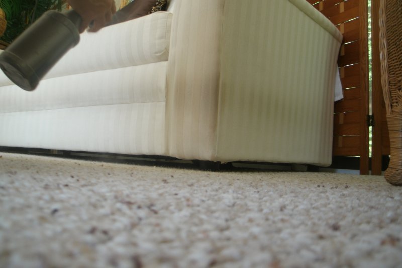

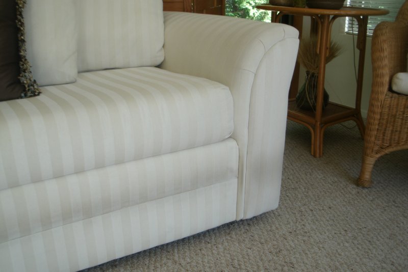

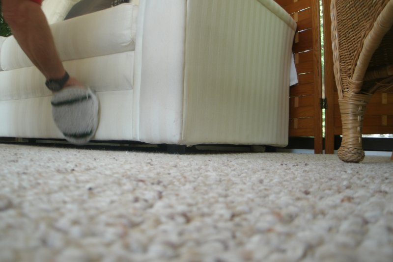

I used some today on a sofa, the customer just wanted the front cleaned where her small dog rubbed against it.
1 oz of the Magic Potion in 20 ozs of hot water (which is a very strong concentrate) sprayed down
then hand bonneted with the remainder of the solution diluted in a bucket
Which pretty much fixed the problem, then rinse the crap out with the SS Upholstery tool
View attachment 2608 View attachment 2608
Came out good

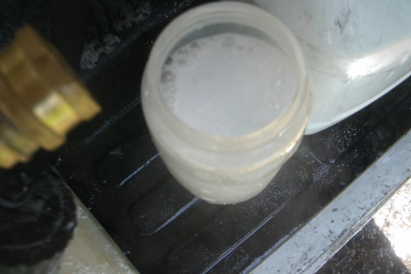

I've had no trouble with the Magic Potion dissolving, from the first test batch I received then this one I bought last December. It's cool to mix it and watch it boil over
lots of chemical activity, then I poured it into the trigger sprayer. I've only used it in pump sprayers and trigger sprayers with no problems but I wouldn't trust it in a chemical draw system and I wouldn't add it to my fresh water tank like I occasionally do with alkaline emulsifiers because of the acidic nature of the product and what that could do to brass parts.
