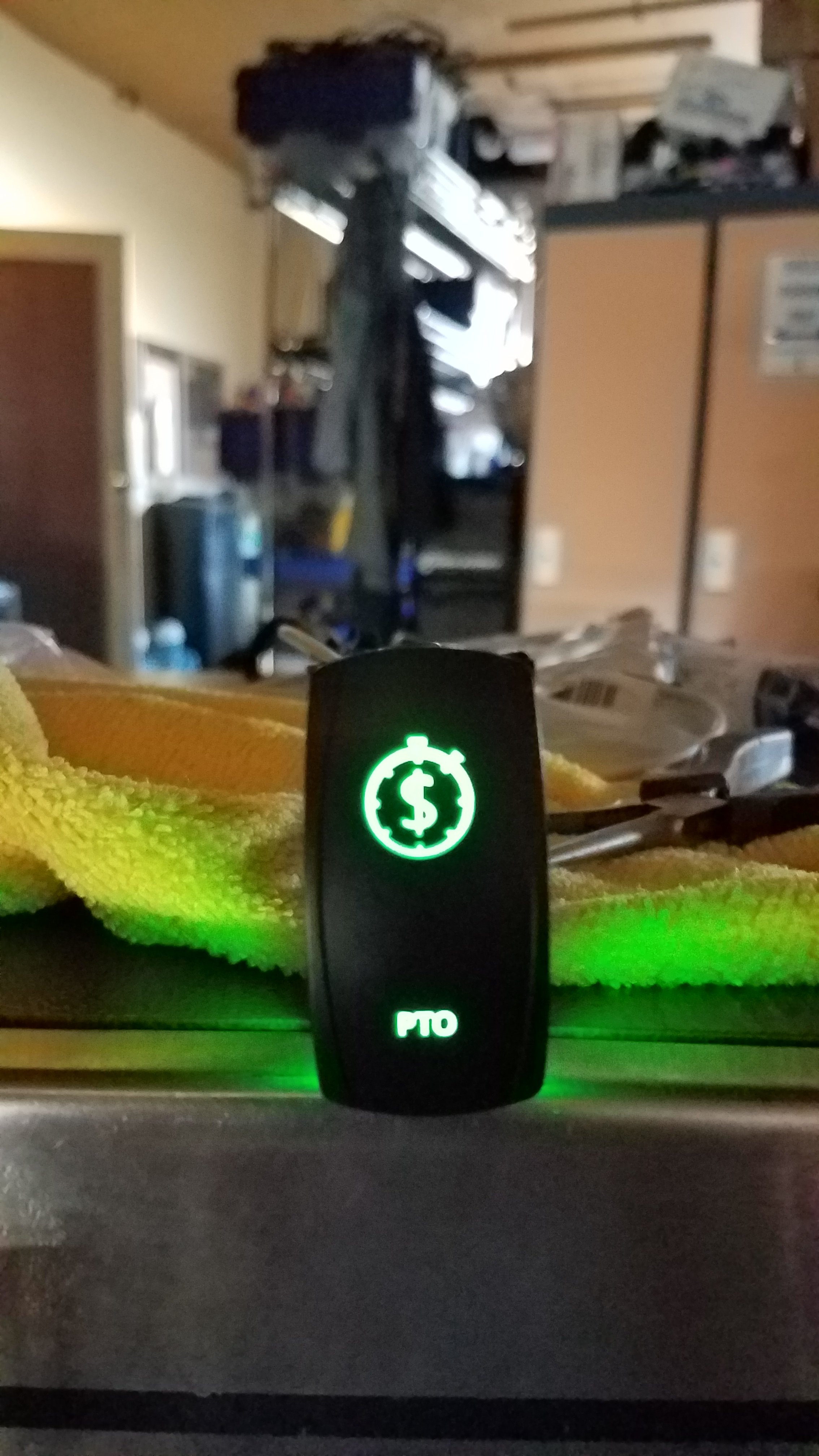

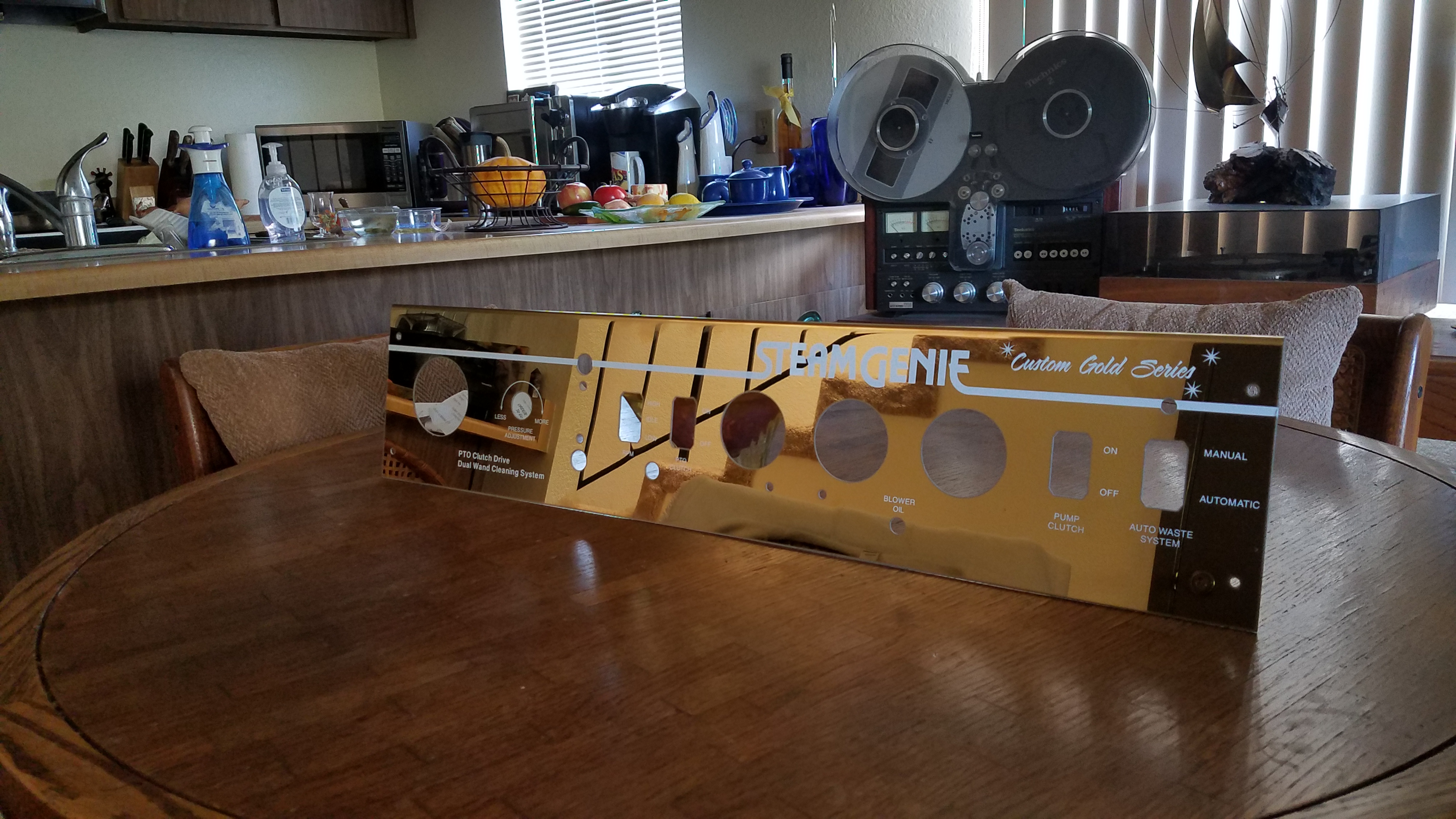

I don’t know about the Bawbaguru but I did “borrow “ someone’s idea for the power takeoff logo every thing else is my design ,it’s badged Frankenstein HO47. It’s the best of 4 manufacturers This machine has a 47blower , hydro pump,CleancoNew version heat exchangers, hydramaster salsa heat After burner, sapphire scientific float valve for fill tank ,prochem waste pump, will use a modified Cleanco engine driveshaft mount and coolant taps,custom powder coating in bronze hammer tone (that baby shit brown is closest color to the dirt on the top of my Dailey driver’s Waste tank)all stainless construction every nut bolt screw and pipe fitting .the control panel is 24k titanium Gold plated polished stainless steel. It had to be sent to Nova Scotia to be silkscreened , emailed 15companies . They were the only ones willing to silkscreen on gold, this machine will not only be powerful,but Will be highly reliable for decades to come it also has a digital tachometer built into the hour meter, not sure if I’m going to tack the engine,pto drive, or blower yet. Even the switch that turns the systems on is custom , a silhouette of Frankenstein glows green when off and the words IT’S ALIVE! glows red when on Started the build 1/19 finished 11/19 started looking @vans 1/20 went to buy 2/20 ........... to be continued.......

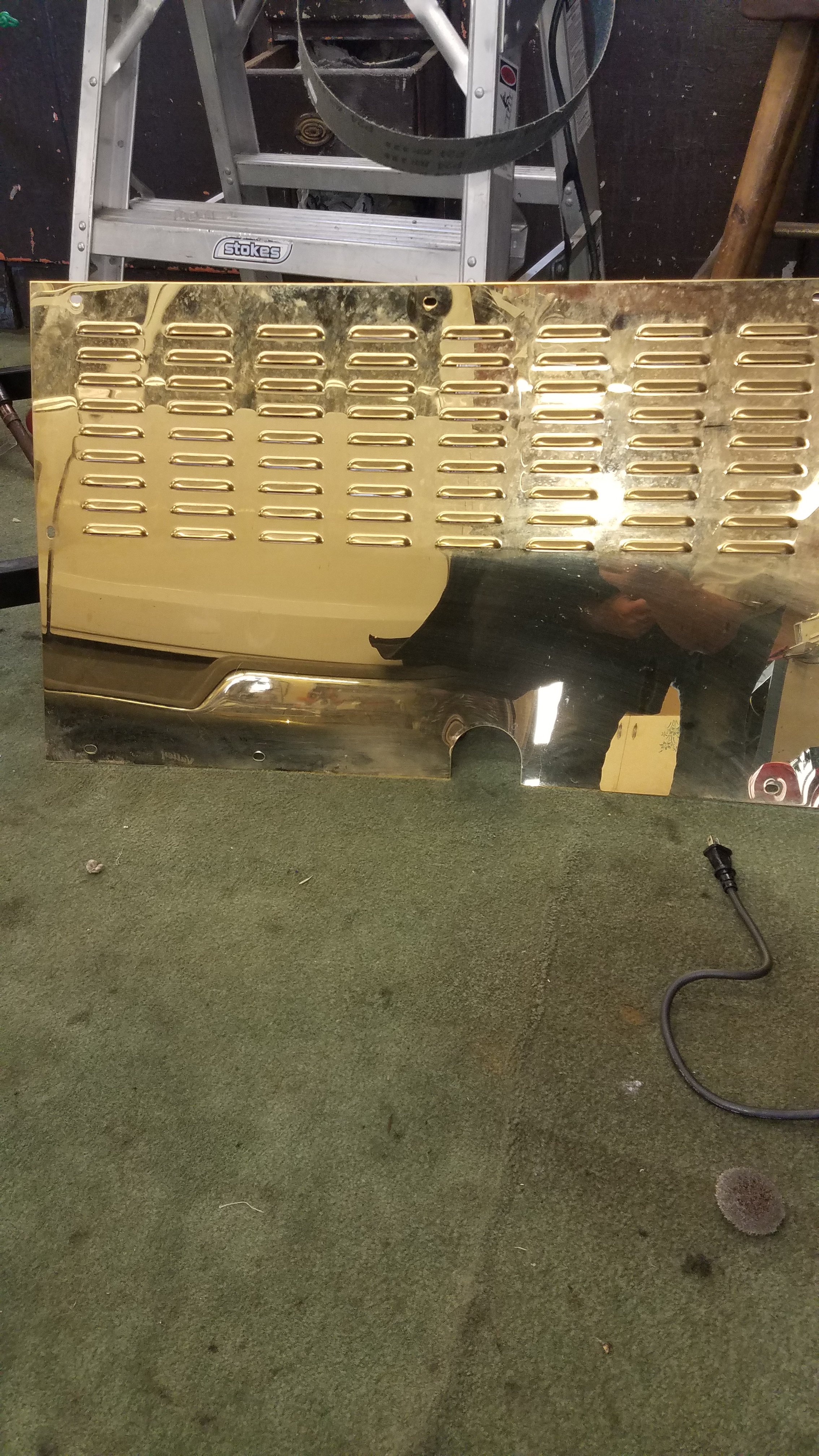

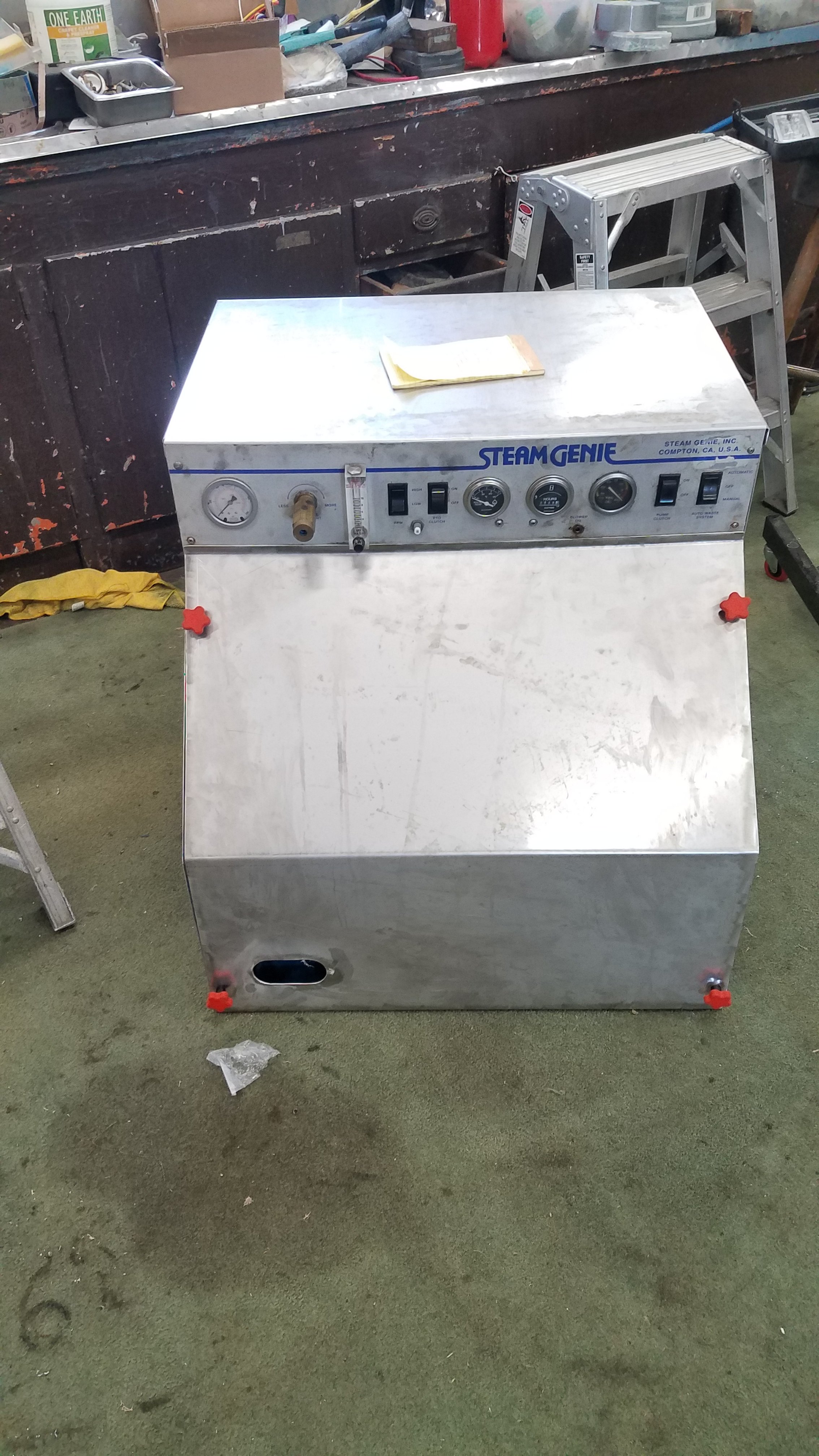

I had a local heating co cut and bend all my tins out of stainless, water jet co in ukiah cut the control panel out of a custom panel i had and never used on an old steam geni hydro2
