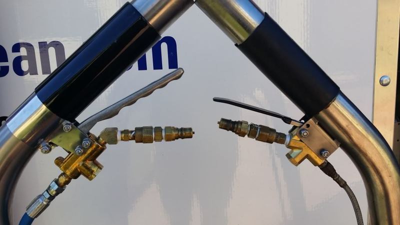

Love the shape and feel of the trigger. No need for the rubber that ultimately slips or splits
Dont like the need of the 45º brass.
Like the adaptability of the trigger hanger.
Jet pattern works great, no over spray, no streaking, nice manly flush.
Boob Fooster is a whiny little ignored girl with a unhealthy obsession with ME.
The Butchering slot works great and can not harm the carpet.
The Mytee handle feels nice but they rubber coated over the nuts so you have to use vice grips or pliers to pinch the rubber and hold the nut.

Very well said,
Bravo to the vice grips on the nuts in order for the MYTEE handle to work. Speaking of, where's that Rep at?

Don't like the need of the 45º brass.
Easy-Touch valve has a 30º angle
Close, but outer jets are too close requiring a different angle
4-Jet is the best configuration & best impact
Should have been designed in, like the Mytee slip-on glide which can be removed easily
Mytee hasn't used that design for over a year.
New one is taller for better leverage & has 4 molded-in brass insert nuts
Photo of the best wand handle in the industry:
I do think all your modifications have made the desirable 4-jet model more usable.
Still looks like slight overspray on the outer jets (illustration adjusted for tilt).
The 95 degree jets made it closer.
Larry

I was just talking about having that type of placment for a valve in general. Reaching with your arm out and your palm turned upward limits movement. Makes you bend slightly to compesate and can cause chronic problems.
