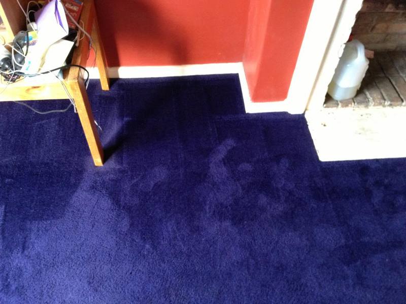

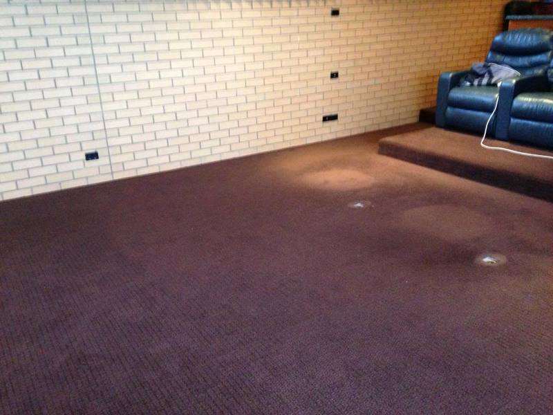

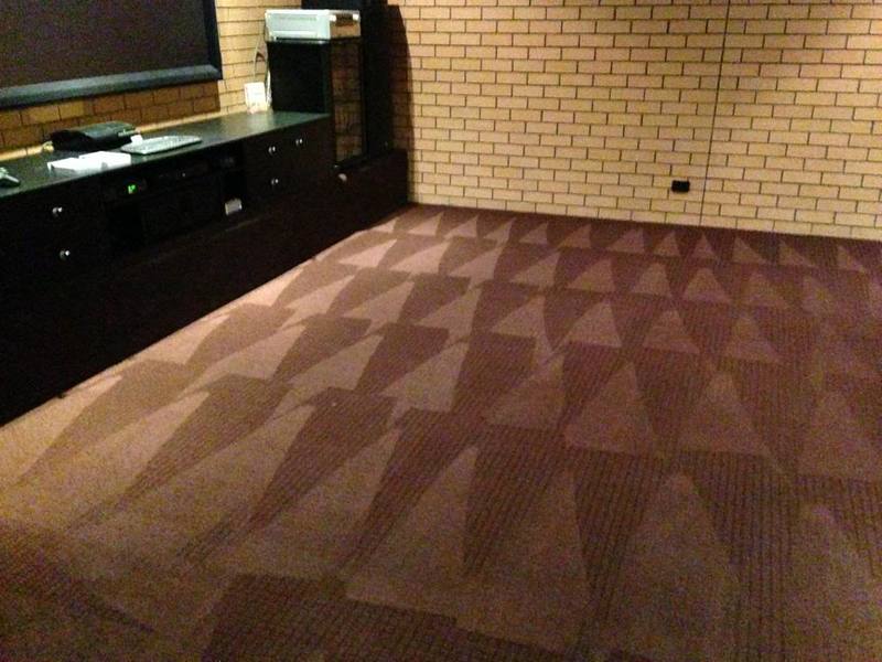

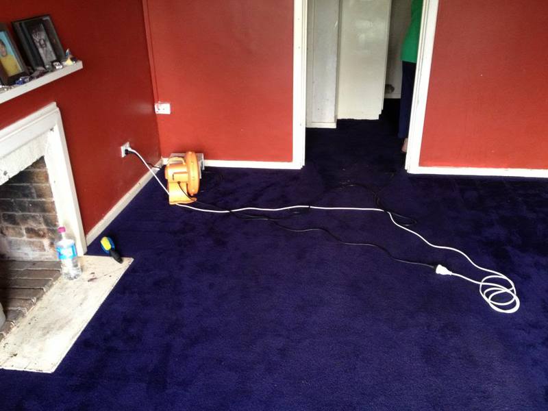

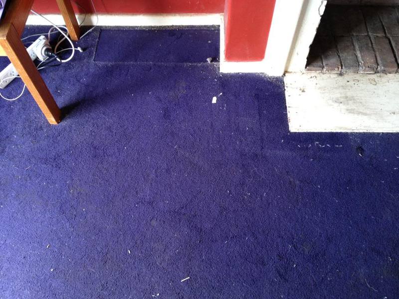

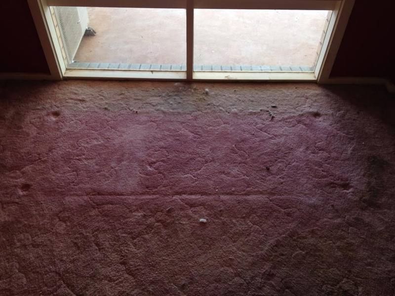

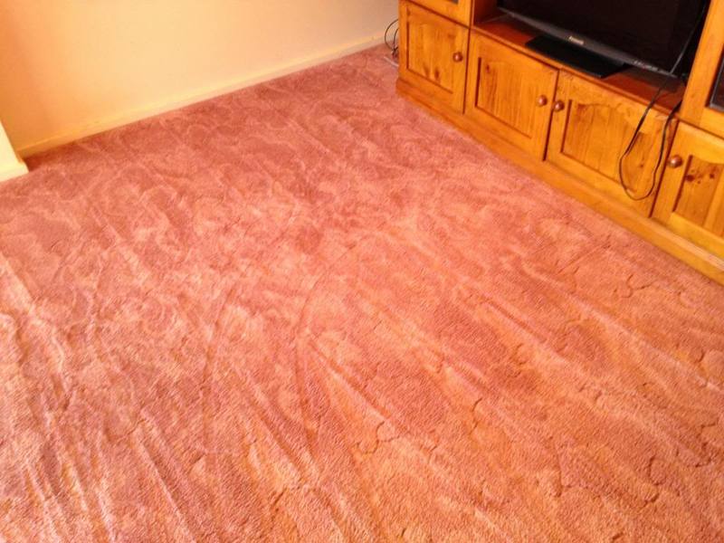

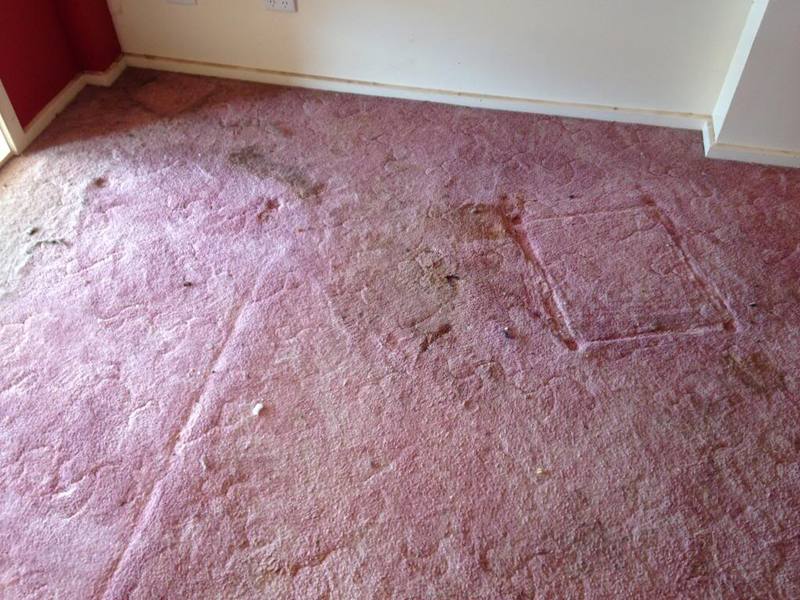

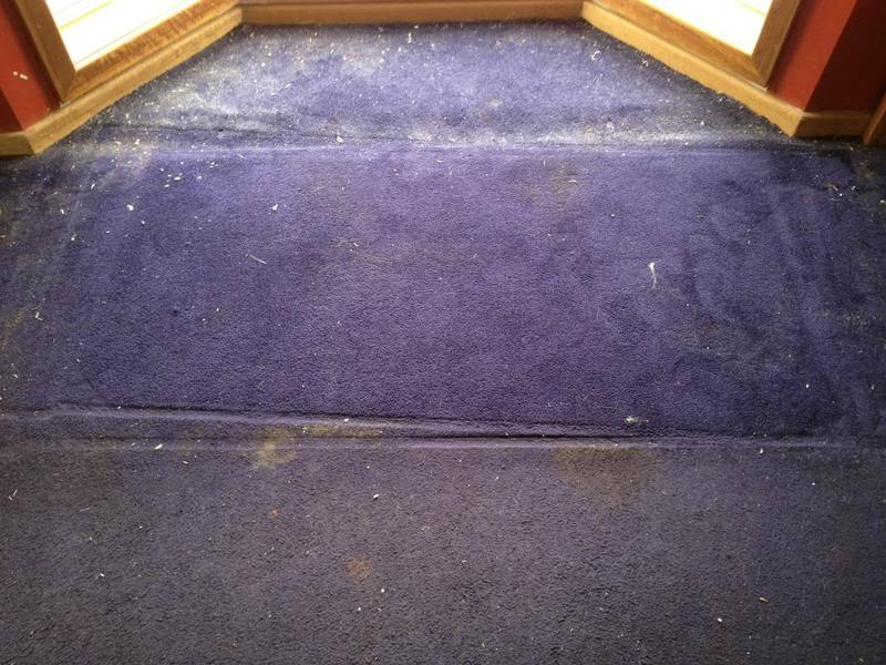

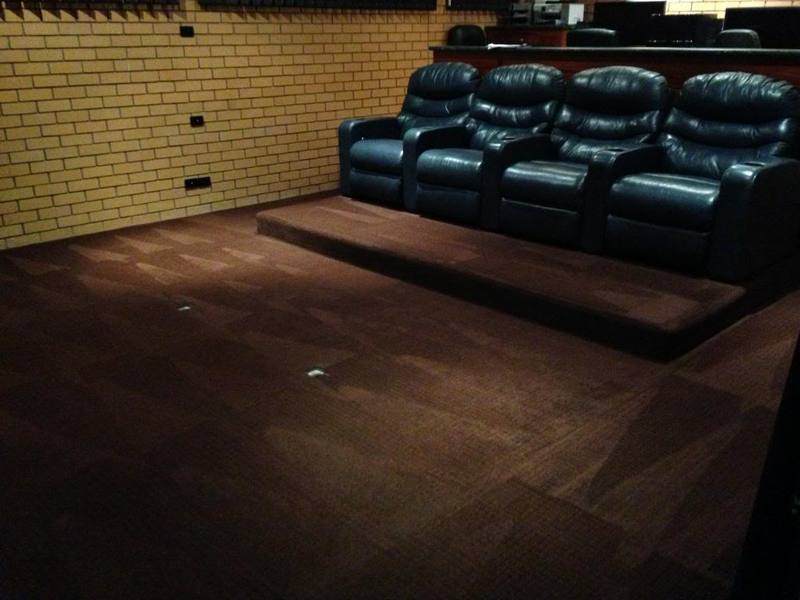

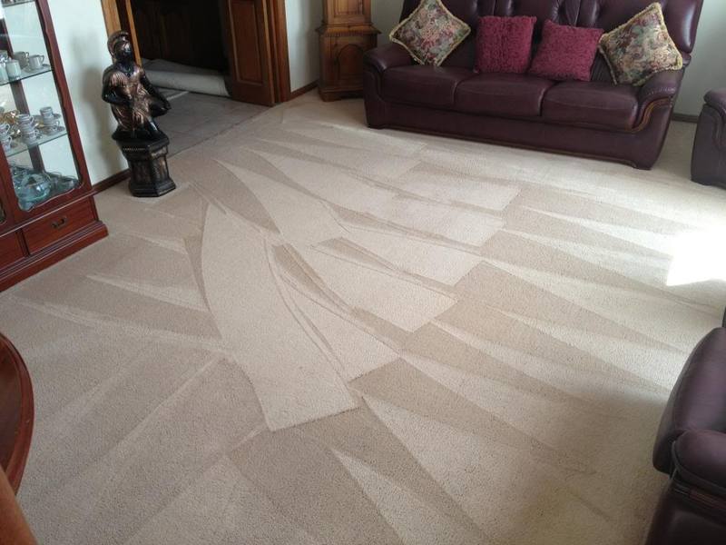

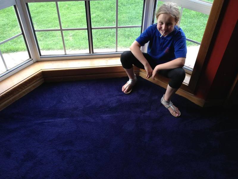

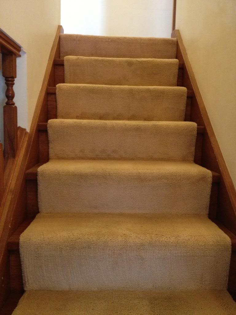

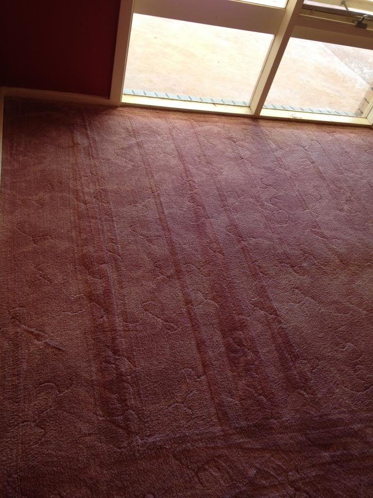

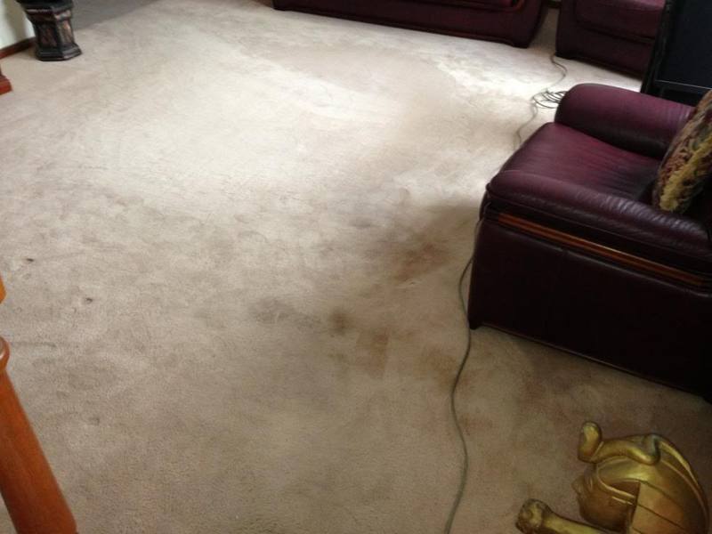

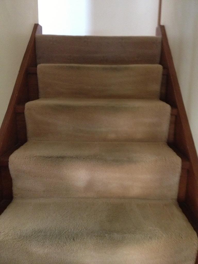

Agitation, chemical and heat are king. If you can apply a good pre-spray nice and warm, work it in and break surface tension then rinse you can clean anything.

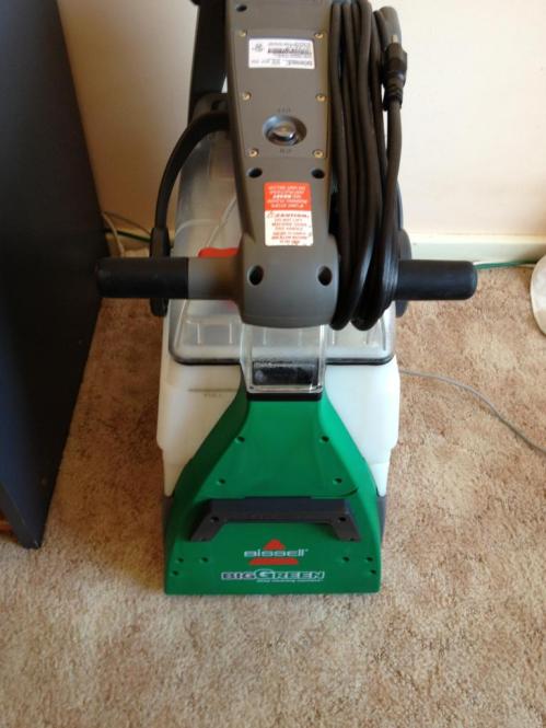

This is my portable. Your machine by comparison is a raging bull on crack and steroids. But here's what my portable has done with Agitation, chemical, time and temperature.
My Kid Thinks Dad Has Kicked The Dirty Carpet's Arse
She's right.....
Grant

Heck yea, Grant very nice work.
Think about getting a sticker or something and cover that giant bissell logo!
Not sure if you moved couch etc. but make sure you have some blocks and tabs. Any dark wood(couch legs and so on) can bleed onto the carpet, wood stain can be a VERY tuff one to remove. Metal will obviously rust.

Thanks, we do use blocks and we check for timber and steel feet too. If it's one of those big plastic feet with no exposed metal we'll clean them and set it back.
So far no problems. In this case this customer doesn't like furniture moved, common here actually. So I do open areas, walk ways, stairs, bedrooms etc.
Grant

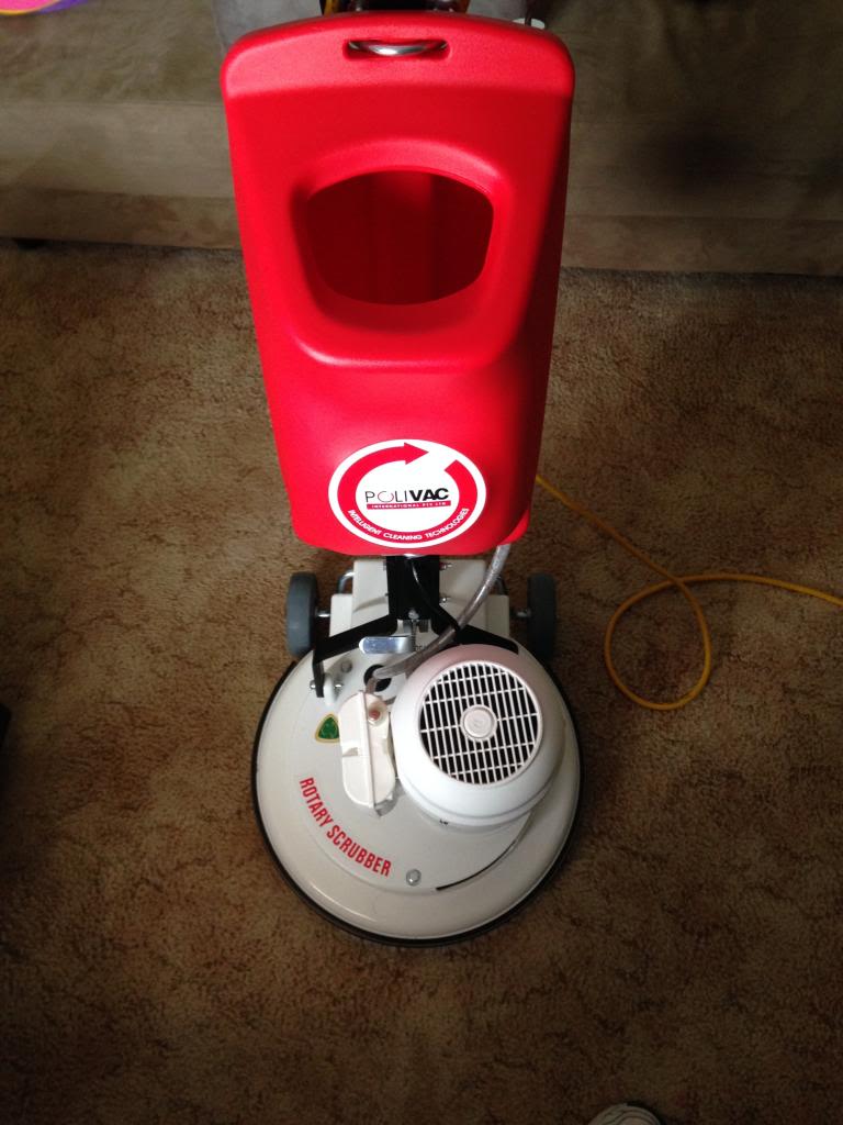

Hey Rogerjr.
I reckon the best thing you could get in a disc machine for agitation. Having gone through the progression of tools I think it represents the most versatile investment. In your market they are dirt cheap.
Here in Australia you pay much more. Used ones do come up but the market is smaller and we see more used machines for high speed buffing than for use as suitable pre-scrubbers.
I bought a new disc machine, a locally Australian made one from a company called PoliVac. They actually export 120v machines to your market too actually. It has been very good and I was sceptical about how efferctively we could carry the ting in our car, which is a bit of a pain I will admit.
It cost me.........
Ready.......
$2,400 AUD which at the time was about $2,320 USD at the time. And even at that it has been brilliant. So for you to grab one for a few hundred bucks - or less - is a boon.
