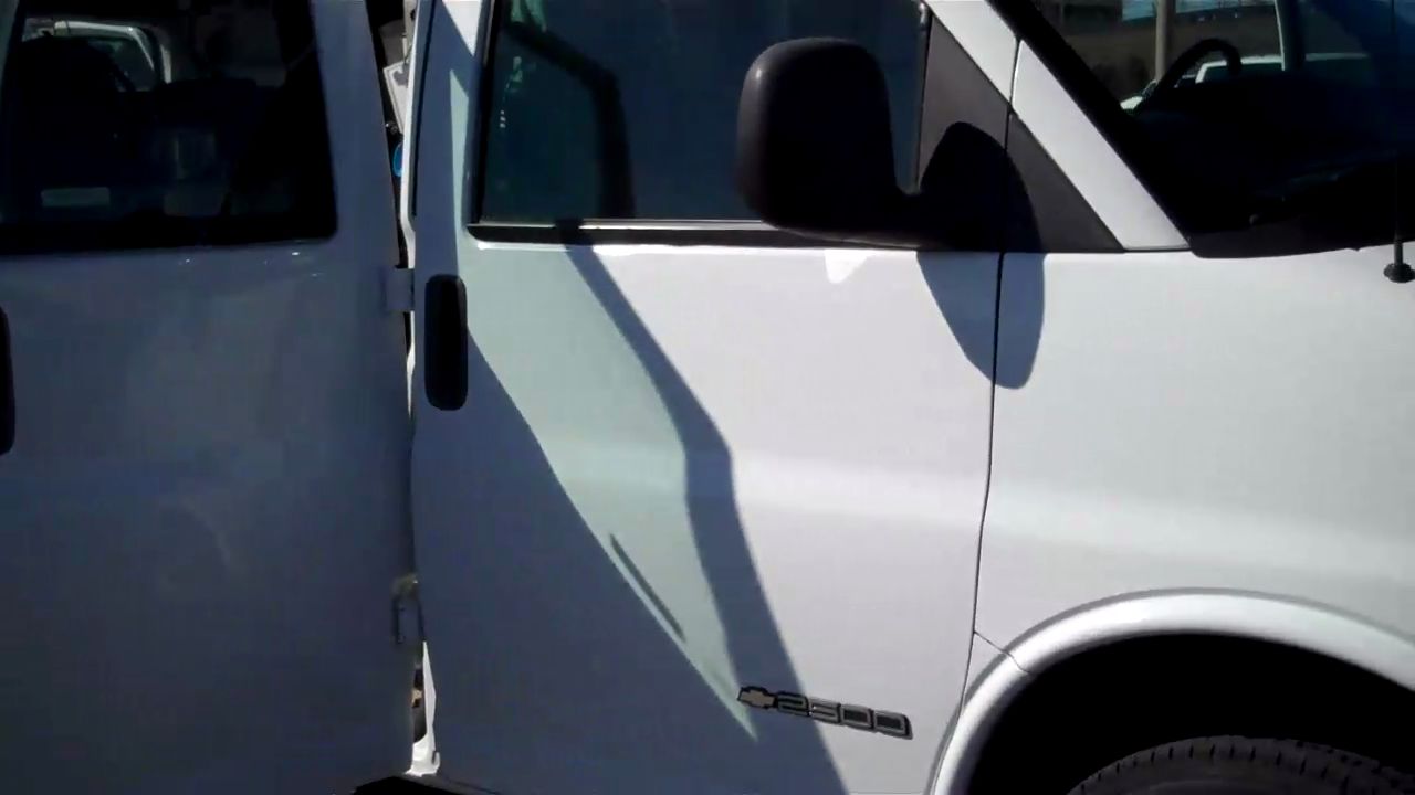

1670 hrs TNT and 98 Chevy 2500 with 71800 miles when I bought it this Monday. This cream puff was listed here back in November.
Have had a few minor repairs to the unit. All purchased local and installed myself.
She is dialed in good now and working great.
3HT was set wrong but fixed that thanks to Ades Gros and Gargan. Les called with more suggestions.
Just wish the truck was an extended. This will probably get rearranged sooner than later.
The Previous Owner basically gave me everything in the Van. THey are retireing. I just have to load 3 or 4 things from my other truck.

Won't play for me... Could be a problem on my end tho..
114,145
click on the photo to play his video
did all that stuff come with the deal?
Consider putting the unit in the side so the engine "power ventilates" the heat out the back..

Yes I was very pleased with the deal I got on this setup. Ades was nice enough to go look at for me. Things fell into place and I drove 540 miles with a wad in my pocket.
Mike the company closed 2 yrs ago officially. I asked twice if he needed anything out of the van. He said NO! 1 wand is mine, 2 jugs of cleaner and a hydroforce. Everything else came with the truck. Clipboard and tools in front mine also.
Unit sat longer than I thought. 7-9 yrs old they bought new. So not a heavily used Truck. Low heat so I cleaned the burner. No help. Ades mentioned Les's vids. The thermostat was set to shut off and 165 degrees. Hit 210 with it today.
Suction side hose clamp loose, that fixed the 200 psi drop. Leaky dump valve replaced got my vac to screaming. Still have to replace the blower to tank elbow sometime next week.
I am very impressed with the Strength this unit has. Hope to get it in a box Van later this year.
