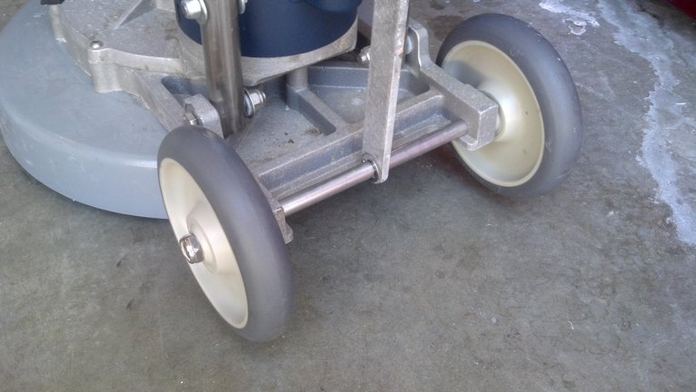

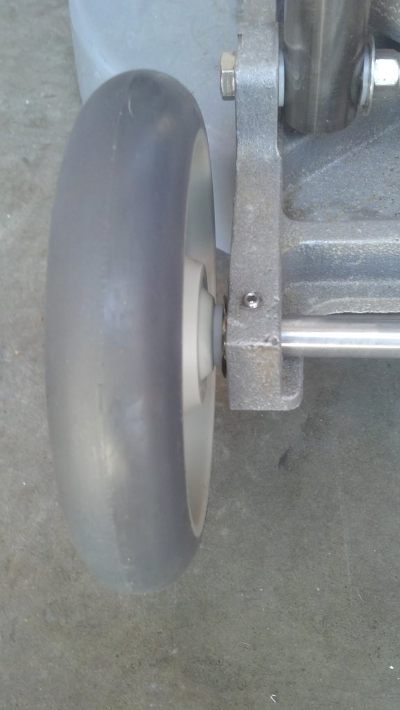

new wheel and axle set up for the HOSS
114,130
Hopefully my days of vibrating down the traffic lanes are over.
The new set up includes a rounder profile wheel. A less tacky (and dry soil attracting) rubber compound along with a one piece axle that does not require internal spacers over the axle itself. Also included are plastic, possibly Teflon, spacer that fits between the inner wheel a wavy washer and the main frame.
Everything appears to be in much tighter spec.
I'll let you know soon if the vibration and related noise has been eliminated.

Looks good...I think that it will quite it down some because there was viberation on the wheels....( I put the teflon spacers on mine when i first got it ) ...but the biggest issue is the metal to metal contact where the axle and the adjustment support hook together......if you grab that thing it wiggles around at the axle.....next time you run it..hold it in place and take the toe of your shoe and rest it up against and the whole thing settles down...probably why whatshisbutts settled down when he wrapped the bungee cord around the axle....

This is not really a performance issue..just a annoying vibration...there has been a few thing that have needed tweaked a little on this machine...most has been from personal preference...

Personally, I DON'T like those type of wheels.
Just as I don't like them on my dehums;
They do vibrate, as you stated, plus, when bringing them down stairs, they jar the machine and the operator.
This may also loosen your nuts.
I much prefer the pneumatic (pump-up) tires for any of our mobile equipment.
Sure, you gotta pump them up occasionally, but hey, what's a couple of minutes every few months.
I keep my tredley (bike) pump in the van just in case.
And soooooo much smoother both on the floor and on the stairs.

I like the shock-absorbing quality of the air-filled tires also.
Mytee has just introduced 10" Pneumatic Grey tires with foam fill on the LTD 500 PSI.
NO MORE FLATS !
