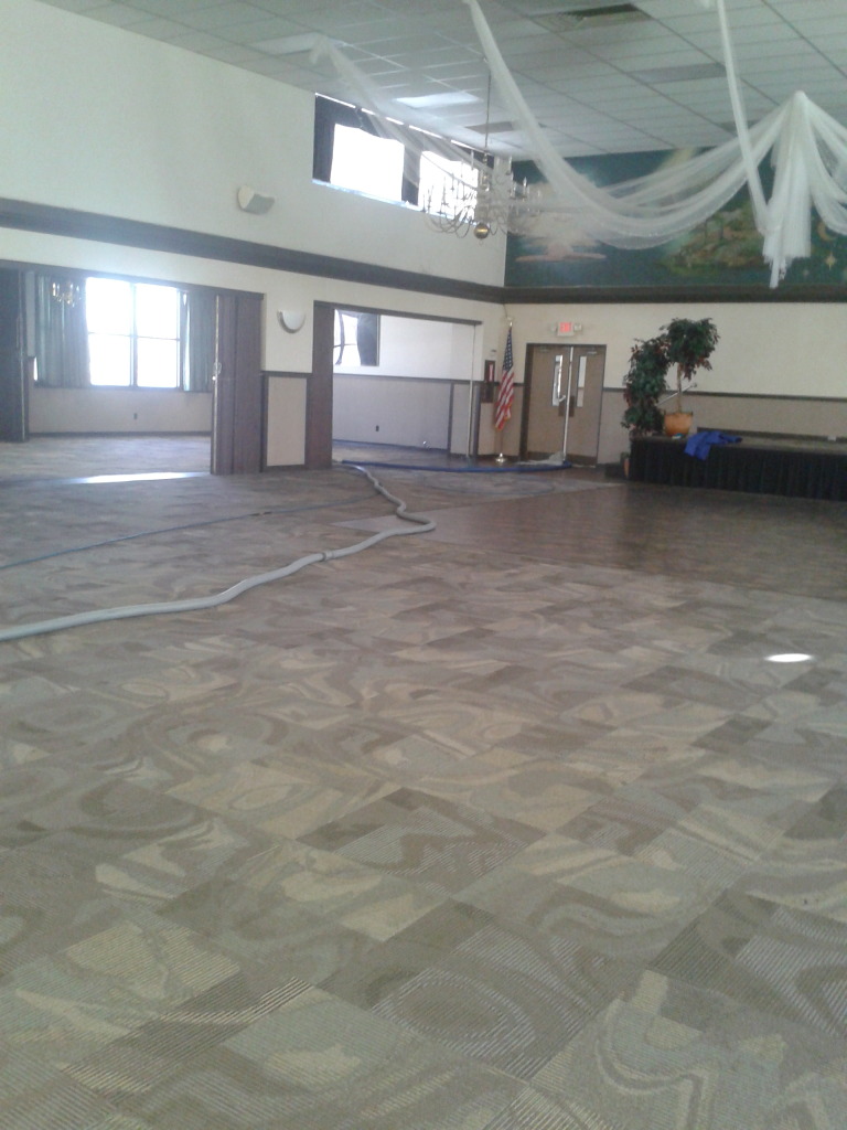

Just finished a nice carpet tile job in a Church catering hall. A few food spots here and there, but with nthe Genesis pushing 230* today.....peeled up just like butter! Slotted glided Ti wand @ 800 psi. My parner, and Wife looking for spots. Once set up, never went out to the van.....just kept cleaning.

The key to successful "cold weather ops" is proper set up, facing the TM away from prevailing winds, APO hoses always draining down....no loops to hold water, keeping the least and shortest run of hose exposed the the elements, doors to the van closed as much as possible. And always keeping the water flowing.
And don't unload your sprayers from the van and leaving them setting outside. I did this morning and the spray tip froze.
