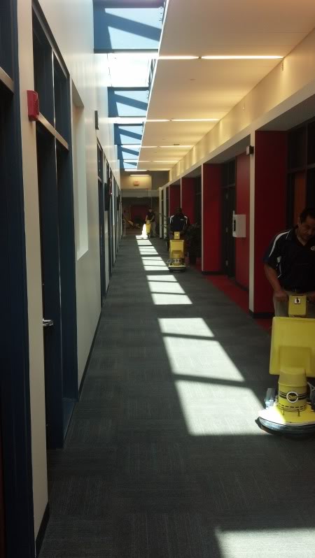

I just ordered what we'll need from jermcapstore.com

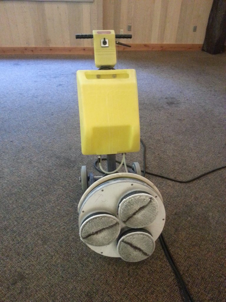

Jerm sold me on some 8" Tuuway pads that have brown ultra stiff brushes imbedded in them. 1500 ft per side then wash em in a bucket and keep moving. Actually absorb some dirt so hopefully we can skip the post padding.
Albert is going to loan me his Cimex so we should be able to plow right through this job.
Those BBC's seem like they are too stiff but they actually work really well on trashed stuff. They do make bonnets for the Cimex too but we rarely use them, mostly for correcting problems.
For Commercial carpet cleaning the Cimex is the king even when you're HWE it works well for preconditioning.

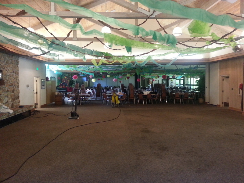

8100 feet left, they do all the vacuuming and will have all the furniture gone
I got my .28 asking price.
Not too shabby.

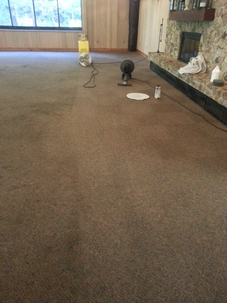

DAY 2

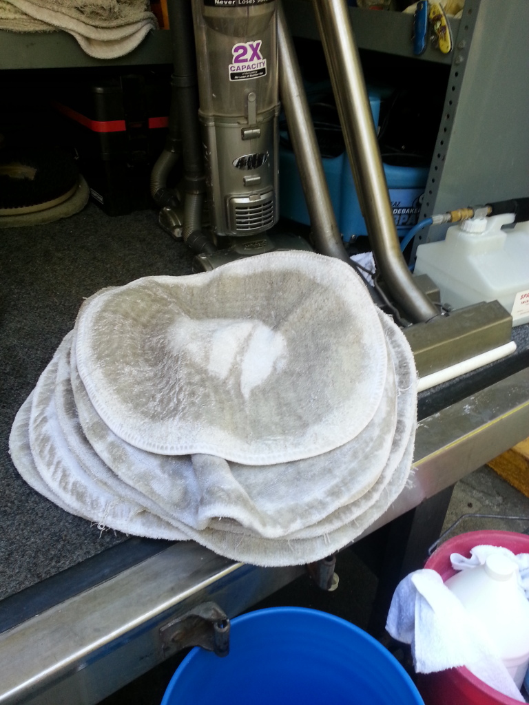

The BBC pads worked fantastic.
Ripped through the nastiest of spills.
1900 feet in 2.5 hours.
one wet one dry pass wiht the Cimex
Follow up pad wiht a 175 and cotton OP type pad. 16 pads used, both sides (60+/- feet per side)
12 gallons of Snake Oil used at 4 ounce per gallon
Heavy spots pre spraey with quart size pump up and Snake Oil, same dilution

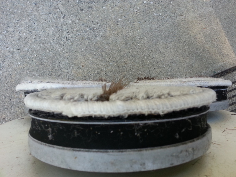

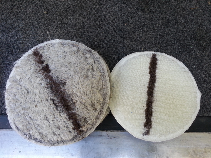

I set of BBC pads used, flipped half way through, not as much attached soiled as I would have though but plenty of wear. I suspect in another 2000 feet they'll be toast.
How much did I pay for these Jeremy? Not complaining, just curious..
Man you nuked them! LOL They dont look as good but you can still get some life out of them!

that carpet is messed up.
It was so slow going I was getting dizzy/nauseous.
My guys get to do the remaining 6000 next week when I'm at Connections.
I told them to take their time and not puke all ovr the clean (looking) carpet.
