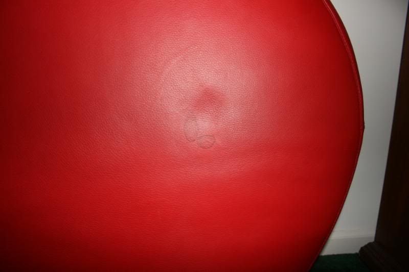

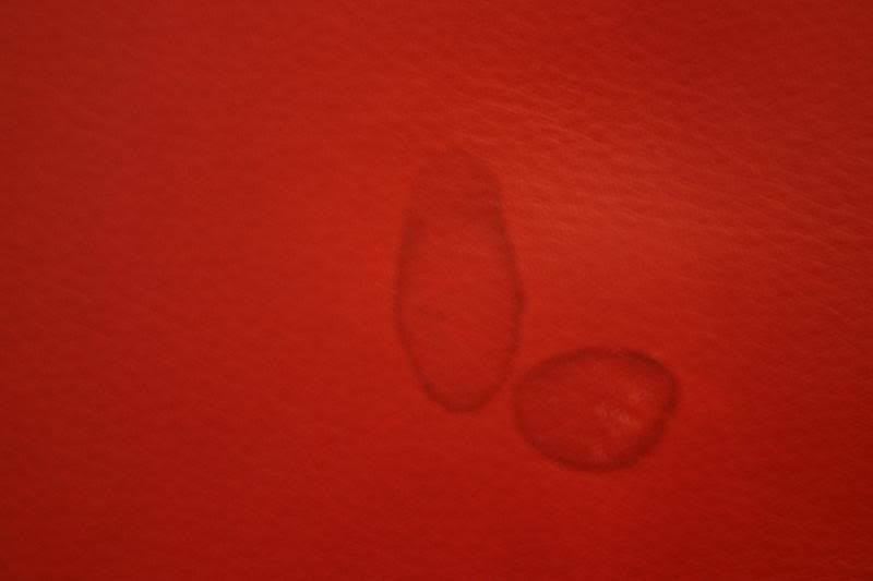

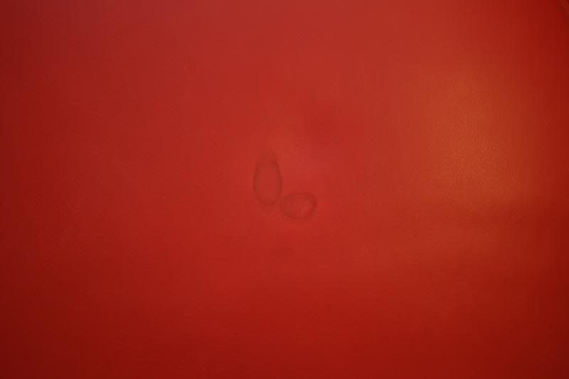

ok leather guys..i got one for ya
davegillfishing
2,229
dave gill
picked this up from a customers house a few days ago. it is a custom made multi colored leather sofa that the cat puked on and the customer did not find the puke for a week or so..he really loves this sofa and would love to have it fixed. i have done nothing other than take some pics..he has no idea of what kind of leather it is other than it was not cheap..
i will answer questions the best i can and will call him if needed for answers although he will be pretty useless..
R
Roger Koh
These 4 products in sequences are for removing the protein based stains.
Only when the stain is satisfactory or unsatisfactorily removed will we then decide on the next move.
What do you think?

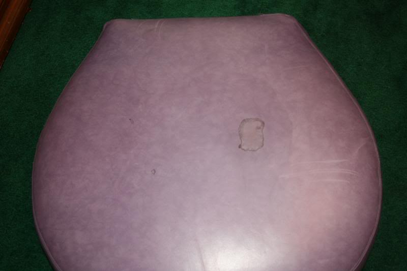

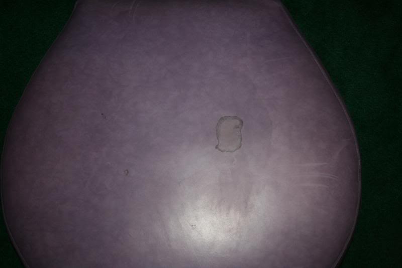

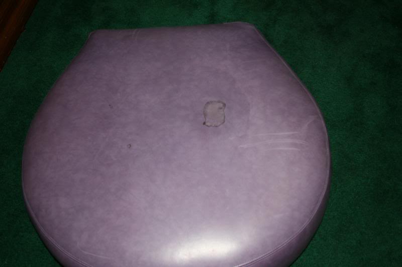

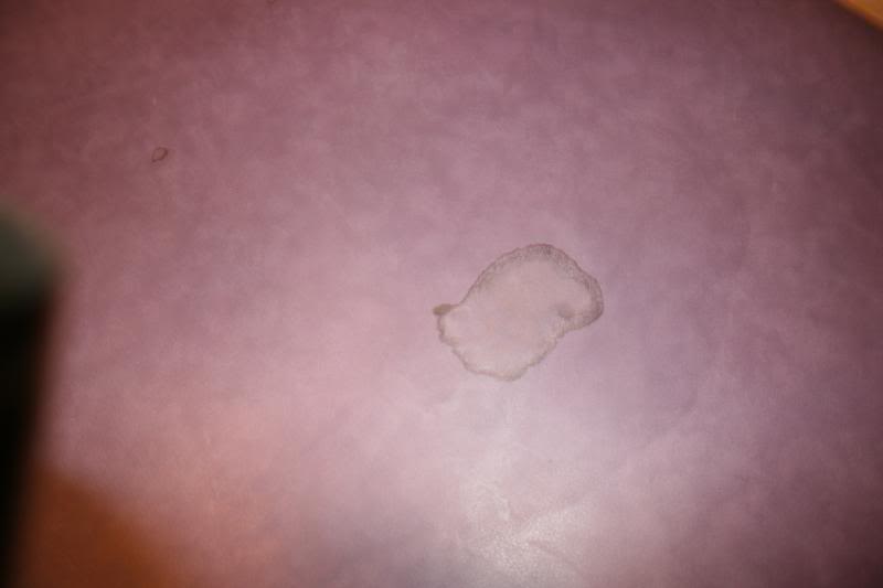

For the purple colored leather it is semi-aniline leather - its semi-absorbent and the liquid has absorbed into the leather leaving the solid on the surface.
Using d’Protein11.0™ removing the solid from the surface has to be delicate using a bamboo skewers with a soften-up fiber tip is best to perform this delicate task without further damaging the color finish (otherwise is a color touch up job for sure - try to avoid removing the colors).
Next use the new crazy idea of soaking up, wrapping up process as according to instruction to penetrate, lubricate and dispersed penetrated stains.
Once the stain is gone while it is still moist fatliquor to soften and strengthen the leather further with fatliquor5.0™.
Follows with the non-stick buttery feel conditioner with the unforgettable classic that always makes customer smile.
Assuming the colors are all intact, if there is a yellowing effect due to oxidized oil then it can be corrected by d’Yellow6.7™ without spot coloring.
What do you think?

davegillfishing
2,229
dave gill
sounds good to me..is this something a first timer should tackle. i am cool with jumping in feet first and getting started if you are confident closely followed instruction will be ok.
can i buy everything i need from you..
if so what would my cost be?
also can you give me some guide line on charging the customer..
please dont forget the teaching fee..i really appreciate you taking the time and i am sure you have better things to do..education is priceless..
thanks dave
