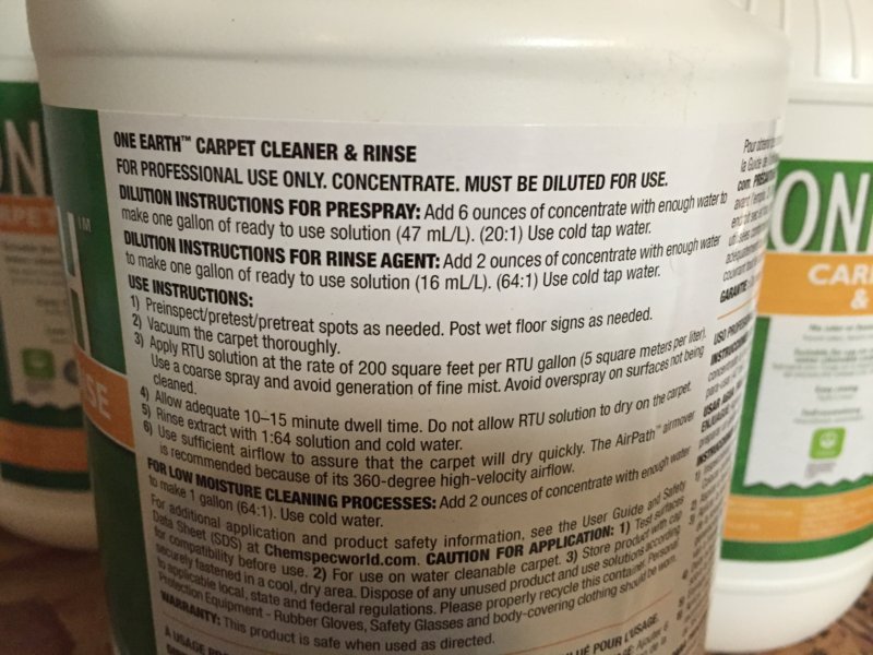

the instructions give the dilution for RTU. What would be the dilution be for using this stuff in a last step injection system?

Is this a new product or is it just a name change for the DFC 210?

I have used that product before and didn,t have much success. Then I discovered procyon (similar product) and have been using it ever since. I use the procyon plus powder both as a prespray and a rinse. I use 16 Oz in a 1gal hydroforce (gotta mix it real good) 32 Oz in 5gal slurry metered at 2-4 gph or 3 Oz to 5 gal in portable
