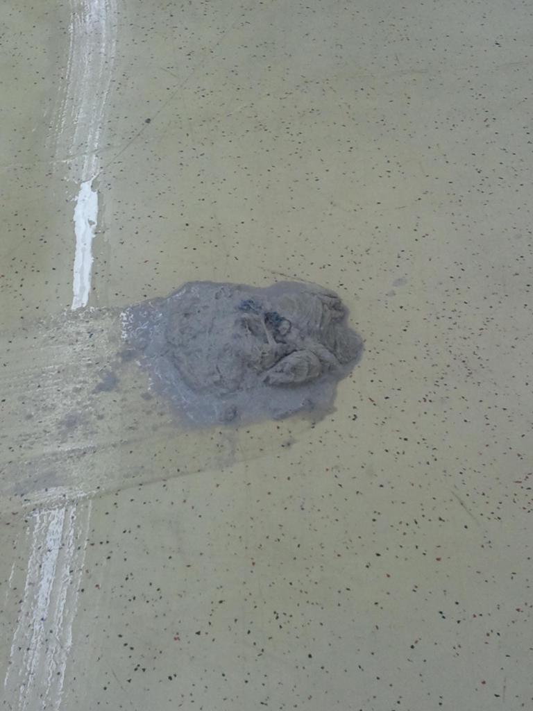

and here ya go.....this stuff is not just going to scratch or swirl off, with out an awful lot of dry shit left over...
here is what happens when it some other type of finish on the floor......and the normal stripper doesnt work....I was guessing a urethane type finish...

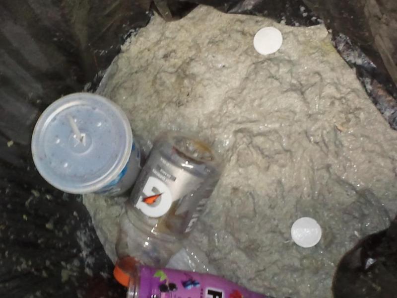

those are cimex pads....it was a doctors office, so small exam rooms, which is why i used the cimex...
the pile above it, is what we scraped when the stripper helped "lift" it a little...PITA for sure.....but it is a decent paying gig, once a year they have me do it... I think its about $600 and takes me 4 hrs, with the wax part, and the carpets...
