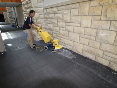

The equipment i use does the work and is not physically demanding at all. The only problem i may experience sometimes is falling asleep after many hrs.As long as i am able to walk slowly and steer the self propelled machine the production is not effected.

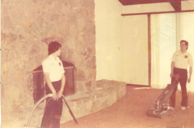

Of course I was a kid back when I could clean like that. Young, dumb and full of........energy. :p

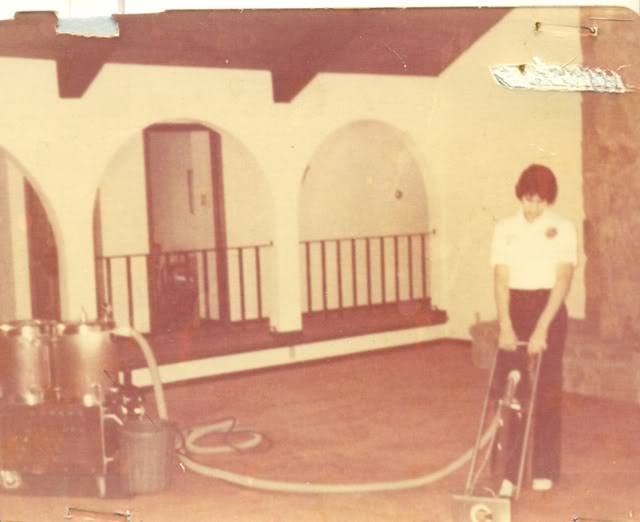

This was what a Vapor vac looked like, no it's not a Cappuccino machine!

Dude that's a pile lifter. We used to pile lift, vacuum the edges with a tank vacuum, then HWE the edge with the edger, 175 the open areas finally extract with the drag wand. All for the low low price of .10 sq/ft.:errf:
