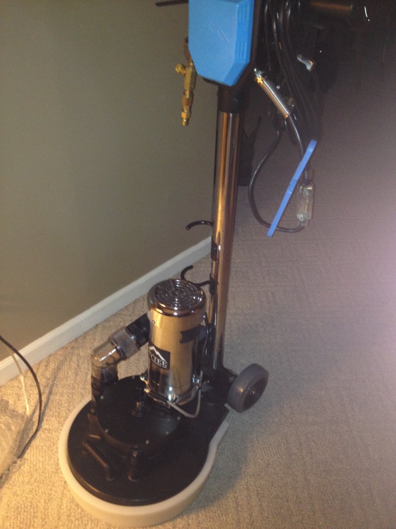

Can you show photos of the pad driver modifications.

Finally got a picture. Bought the reconditioned one and they didnt have one so they sent me a new one. Got it for a steal

Mike
Forgot to upload

I have seen others that cut a small section and place it on the machine with a quick cuff. That is what I plan to do here in a few days. Waiting for temp to warm up and going to try out
I ran out of aluminum channel that's why one is short. The other two fit snugly between the outer trex and the brass inner hub, if that makes sense. PS this one works fine, but if you can get one with short bristles.
