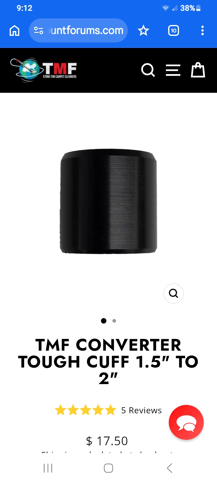

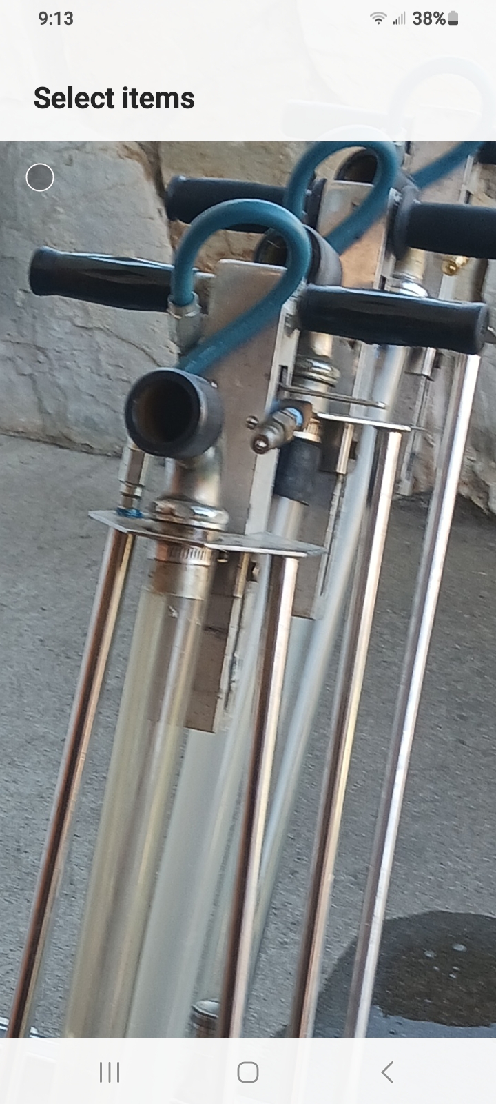

Rob sells a nylon adapter to adapt an 1½" wand to accommodate a 2"hose i put um on my drag wands
Screenshot_20260302_211201_Chrome.jpg Screenshot_20260302_211340_Gallery.jpg

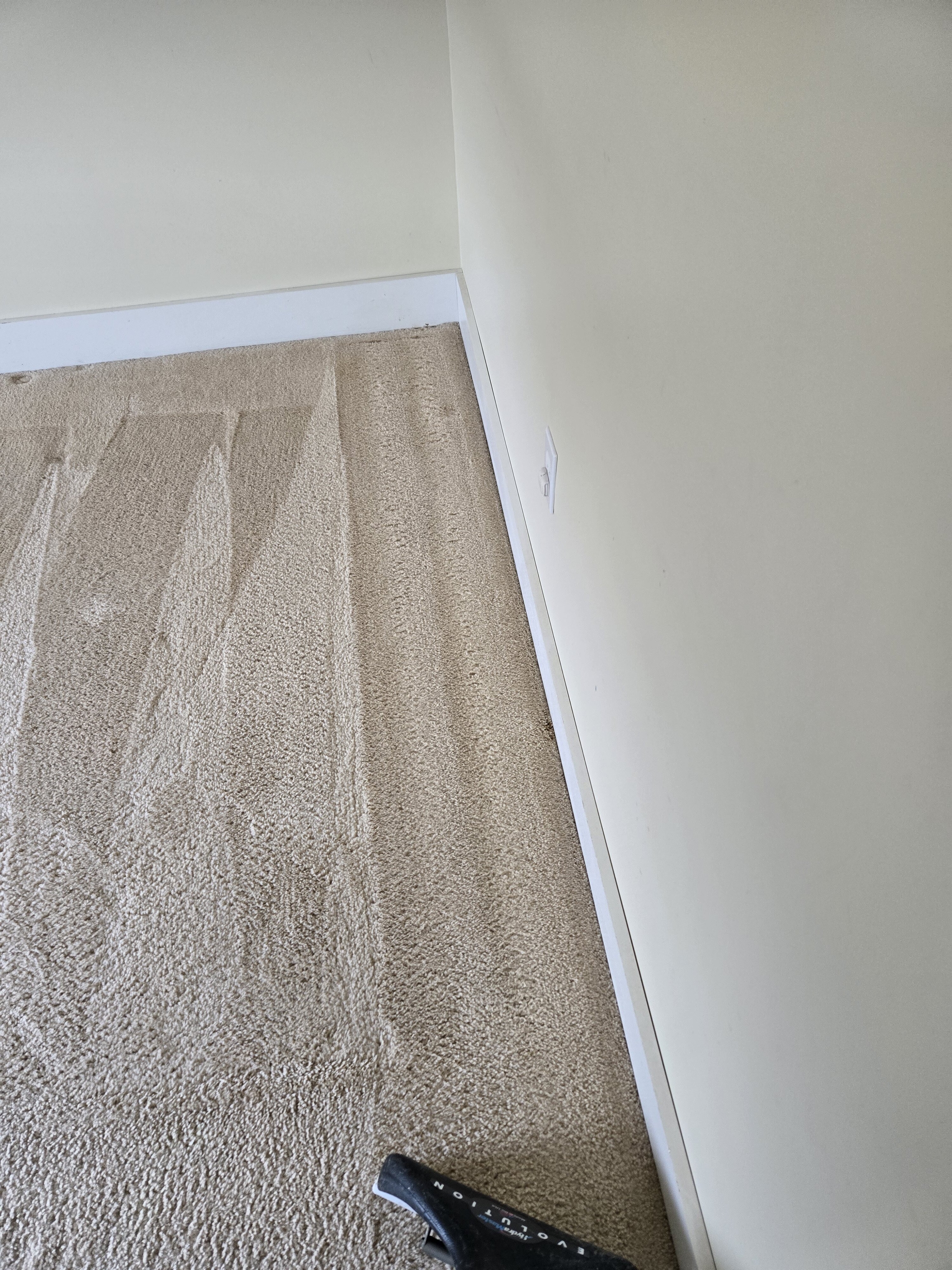

What's up with my streaks y'all? I turned my pressure down to 400. I tried offsetting my jets one way, then the other, no luck. Then made sure the jets were lined up perfect, no luck. I ended up just doing a third offset pass after my normal 2 passes on each stretch to eliminate it by streaking the unstreaked portion. There must be a better way...
Mike I confess, I just use your Chosen Wand as a backup now. The extra inch of coverage on my Evo 13" saves me a few thousand passes a year.
14,611
Does the evolution have a center pin in the vacuum slot?
I had the same problem with a mach12 wand. Couldn’t fix the problem so I just got rid of it

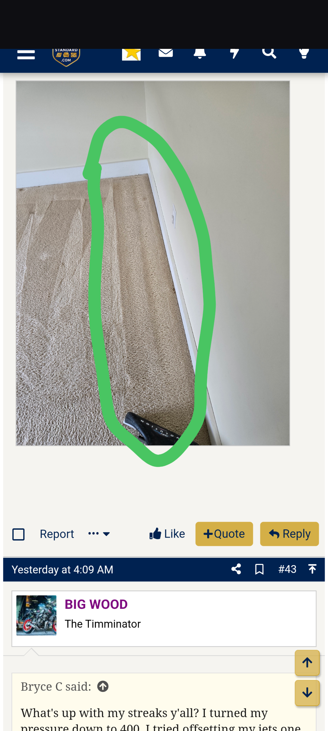

The line in this photo, is that what you're talking about in regards to streaking ?
that's pile distortion.
The spray bar on your wand could be improperly adjusted and your brass jets are likely worn out
Put some brand new steel Jets on it and adjust the spray bar/ manifold so that the Jets are striking right behind the Glide, even if its touching the Glide by 10% that's okay
Bryce, was this happening every stroke or just along the wall as pictured?
Every stroke. I adjusted my pressure down to 400 psi, tried offsetting my jets, and none of it worked until I just did extra passes to streak the unstreaked areas.
