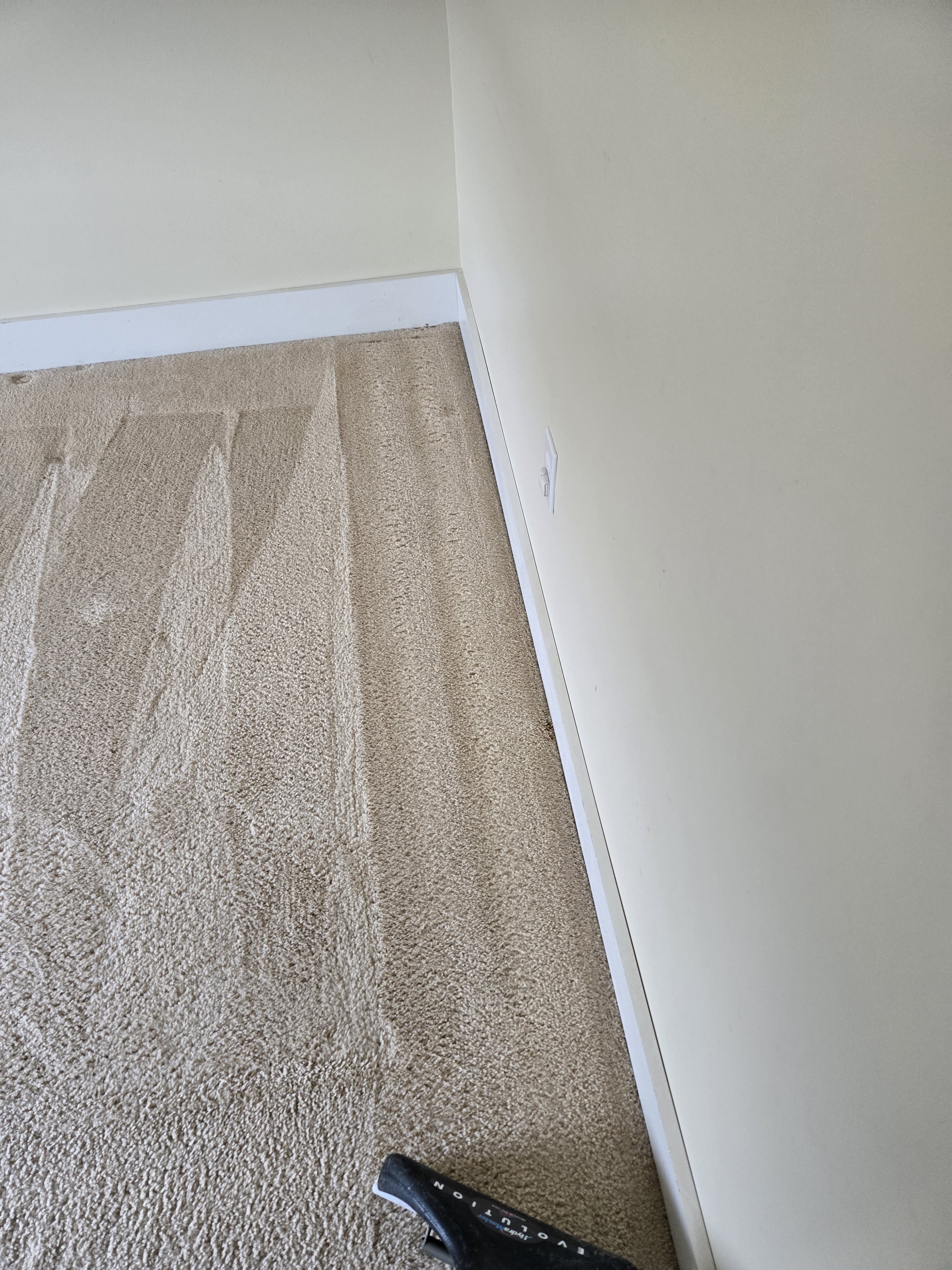

The line in this photo, is that what you're talking about in regards to streaking ?
that's pile distortion.
The spray bar on your wand could be improperly adjusted and your brass jets are likely worn out
Put some brand new steel Jets on it and adjust the spray bar/ manifold so that the Jets are striking right behind the Glide, even if its touching the Glide by 10% that's okay
Yes sir 🫡
Great advice, thanks Mike. You don't think those are clean streaks but rather pile distortion? If it was just pile distortion I'd imagine aggressive grooming with a black brush would correct it, but it didn't. Unless by pile distortion you mean the sort that is actually permanent damage?

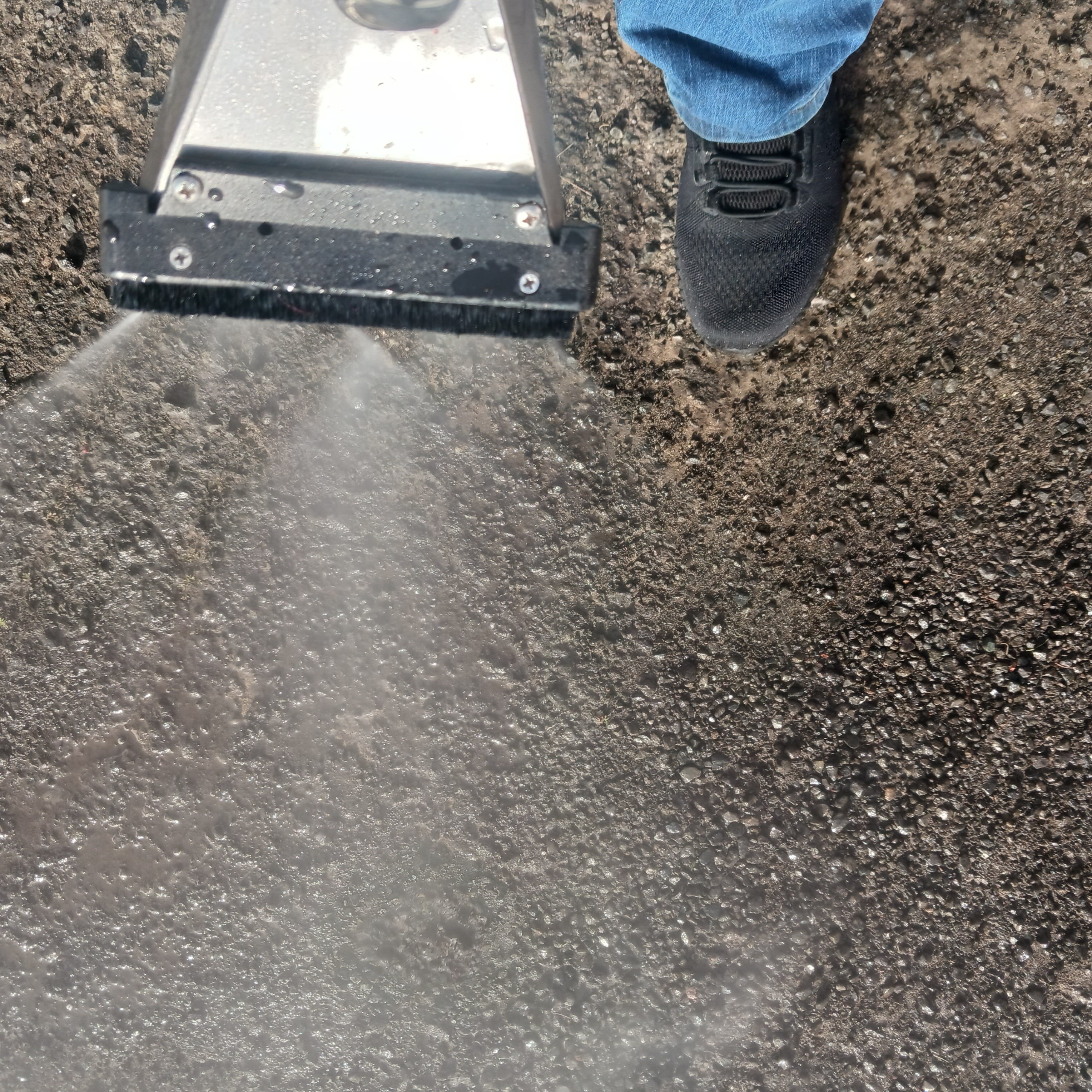

When we wer talking about spray patterns of 2 (or more) jets hitting one another causes streaks this is an example of that. The two patterns meet and distort and put more soulition down where they meet (middle in picture)
Then why am I seeing 2 streaks directly beneath the 2 jets, and not 1 streak that is centered between the 2 jets?
Dwain Ray
Jul 22, 2020
1,142
I dont know. I bought a pile of attachments off ebay and was playing with um this afternoon and checking um out amd remembered this conversation but if you look closely at that picture , if that was a carpet tool i would expect it to streak in two places in the middle and to the left where the spray hits the side of the attachment and distorts the pattern. That particular attachment it probably doesn't really matter, its a hard surface tool

Pile Distortion is quite common on those apartment carpets. Cleaned thousands of them over the years. Wands with jet extenders that shoot straight d0wn really make them bad. I have had my Evolution cause slight distortion on that same carpet. Normally just along the walls where the carpet is still new. Not so much in the worn walk patterns. I think I noticed you had a wider glide on the Evolution wand in a picture awhile back. If you pulled the manifold back to adjust spray for the wider glide, chances are you are not shearing the carpet, or angling the jets to hit the glide anymore. This will allow for the distortion.
That's incorrect information IMO.
Raising the manifold without turning the Jets isn't going to affect what little shear angle that wand has.
117,252
What would I know. Not like I use the wand everyday on multiple carpet types
I suppose raising the Jets a whole quarter inch could lessen the impact but I would need to see photos taken from the side showing that the sheer angle changed in order to even consider it
I'd be more inclined to think that your sticky grabby black Delran Glide with the goofy back lip was providing you some level of agitation that is now gone with your perfectly round PTFE Glide
