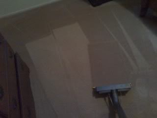

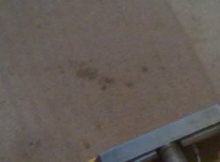

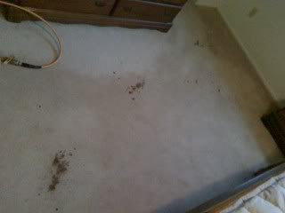

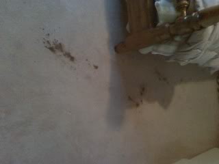

got a call from a regular old lady who had a fit of the Whistling Crackers..
perfect opportunity to test the 123 Resi version.
I mixed it strong and boosted with the D-Limo.
Gave it 5 minutes and rinsed with Soap Free.
Got the bulk of the shit out but far too much did not come out after heavy and HOT rinsing.
I thought I'd try some O2 but seeing how its pretty much the same shit as 123 I used my trusty Redline with a 40 Vol boost and Pow!
gone..
Maybe 123 needs some enzymes or STPP.
