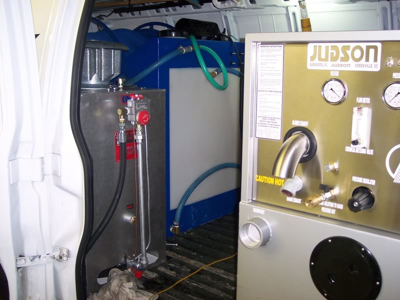

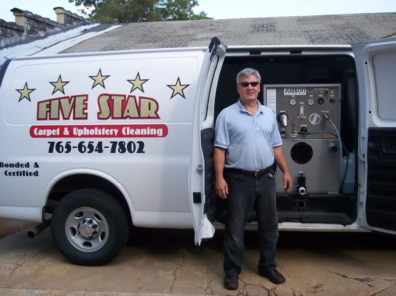

Jeff Woods from Indiana took a road trip to Judson to upgrade to a higher performance machine. Jeff was fairly happy with the heat of his Thermal Wave until he went to high flow. The Thermal Wave would not sustain temperature with a high flow system. His new TNT will sustain 240 degrees high flow.
One of the issues that Jeff was having with his Thermal Wave was extreme difficulty repairing the unit. The TNT will have about a 50% operating cost savings. Before Jeff left, he asked, “Where is the manual for the unit?” I replied, “The manual is on the front of the unit.” It is the white sticker going down the left side. That is how simple aTNT really is.
We also removed the pump out system off the Thermal Wave and mounted it on the TNT, but we added a real nice inline filter system to it. We left the Blue Line water pond and reel system, and when we were finished, Jeff had considerably more room in his van.

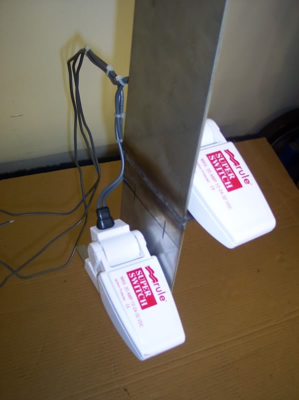

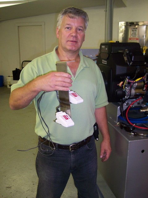

Jeff has very good engineering capabilities. He helped us design this switch system for the recovery tank. The bottom switch is to activate his pump-out system. We eliminated the $180 Blue Line switch with a common high amp boat bilge pump switch. These are very common and can be found locally. The top switch shuts the machine off when the recovery tank is full

Ken, One of the unique features of the TNT design is the location of the engine. Air cooled engines have a high CFM cooling fan. The TNT engine is mounted with the cooling intake located between the van seats. The air blows around the engine towards the back of the van , picks up the hot exaust air from the Little Giant heater and continues out through the rear doors. You can sit in the seats with the machine running and not feel heat. A roof vent would probably help but is not necessay as we have not had any heat issues.

I would like to thank Les and the Judson crew for the installation of my new TNT last Monday and Tuesday. I was to have it done later in the week however my thermal wave would not start on Saturday so I called in hopes of coming in sooner. He actually answered the phone on a Saturday and said come on down . I arrived Monday morning at the shop [ 600 miles one way].Had some minor technical things to figure out and by Tuesday evening I was on my way back to Indiana. My wife had re arranged the schedule and I only missed one small job. I have 8 hours on the machine and one thing I can say for sure is the heat is AWESOME. I run 12 flow at 400 psi 230-240 deg and the heat never drops.The 45 blower is more than enough for single wand. I had Les put a Bayco 15 relief valve on it and it has plenty vac. The chem metering on it is simple and works great, it looks like my rinse chem cost will be going way down. Got to get back to work. Thanks again Les and crew for the great machine and install. PS Thanks also for hospitality and great food! I gotta get me some more of them BBQ dogs!!!! Woodsey
