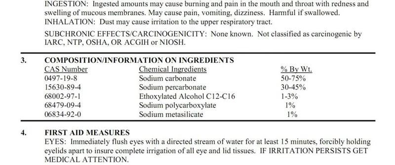

From Oxiclean MSDS (with a i)
images
There is another product OxYclean (with a Y), from Melrose Chemicals, which is sold for industrial use which is lye based.

thats exactly the info I was looking for. cobbs looks like the best deal I have seen, I will stick with it and maybe use some oxy when in a pinch

Sodium carbonate (the #1 ingredient in OxiClean) is not the same as sodium percarbonate. Sodium percarbonate is the real deal. Sodium carbonate is just one step above filler. You do want a product that is all or mostly sodium percarbonate.
