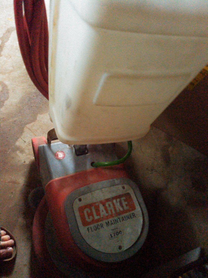

See if you can find old clarke with the 1 1/2 hp motors and with the shampoo tank. Indestructible machines.
Cleaning Professional
28,284
The clarke is much bigger and heavier, we used to let little kids ride on it to give us better traction. Could never burn it out.
