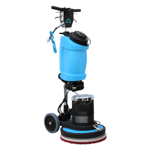

There is also a new Hi-Speed 1.5HP Rotary with Spray System. . .
that Paul Brown has been using for commercial encap work.

My only fear about having a spray system out ahead is control of the spray, probably a pump sprayer or multi sprayer.
My problem is investing in stuff I might not use agian for a while. I do have a 17 inch 175 1.5 hp. If it was an account that needed it once a year maybe, but thye seem to be having a hard time pulling the trigger on this cleaning.
Also have a 13 inch hild, and hopefull a 10 inch crb by then. I could have two guys scrub while I bonnet.
