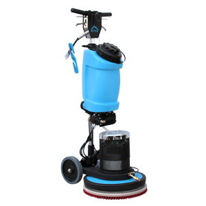

Apply enough Carbonated Solutions to completely saturate the affected area. If the pet stain is relatively fresh you should get a strong ammonia odor, which is caused by the cleaner effectively breaking down and destroying the urine. Remove the spot with an absorbent bonnet under a 175 rpm floor machine. The friction from the bonnet and the weight of the machine does seem to help bring the stain out, but if you have to extract it, you should still finish with a good terrycloth hand towel.

Our preferred method of use is as a pre-spray, followed by a 175 rpm floor machine with a loopy yarn bonnet, BUT... this cleaner is effective with any system. It is a very effective pre-spray for use with HWE systems; our son uses it this way as he often cleans several large facilities that require HWE. The thing to remember is to forget what you know about soaps and detergents. This cleaner doesn't work the same way as most of the chemicals you're currently using; for one thing, it doesn't have to be rinsed from the carpet.
One of the best ways to sample this cleaner is to fill a one-quart trigger spray bottle and just keep it on hand as you clean. When you encounter a spot, simply spray the cleaner on it and keep cleaning. A little dwell time may be necessary depending on the spot or stain you are dealing with. When you hit a spot with the cleaner, don’t make the mistake of thinking the product doesn’t work if the spot doesn’t magically disappear on contact – that’s not the way this works. Instead, the cleaner goes to work on the spot or stain and “holds” it in the solution until you remove it.
