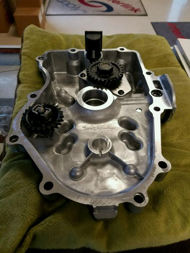

Paid it off last month, this month a crack in the engine... Uggggggg.

Looking at the crack if it is a crack. It shouldn't be the cause of oil leaking. The gasket would be a full circle where the bolt goes through. the top of the circle should still be holding oil in.
If it is leaking beyond what is acceptable to you, then I would also second or third the opinion of a new engine. Paying 3-4 hundred for a new part then paying to install it would be throwing good money after bad. One of the reasons that older engines leak oil is because of crankcase pressure. Engines have a hose going to the intake that removes crankcase gasses and creates a negative air pressure in the crankcase. As the engine wears the gasses escaping past the pistons begins to create a positive pressure in the crankcase causing older engines to leak oil.
I understand it was leaking from the beginning but it is now a well used engine and sometimes it is very difficult to solve oil leaks.

43441-jpeg.68578
Turns out the bevel is on the TOP of the motor... Nothing was changed to where the oil resides. Chris at RenoLink say they used more and better RTV, rant it under full load for 45 minutes and good so far
There should have been a recessed channle cut 360 around the mating surface IMO
