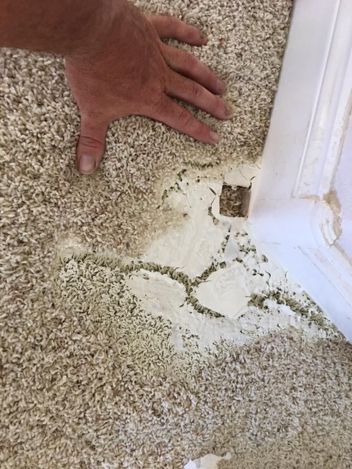

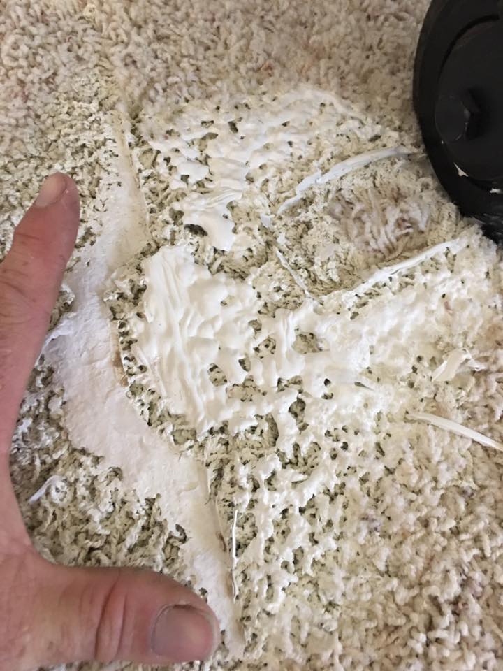

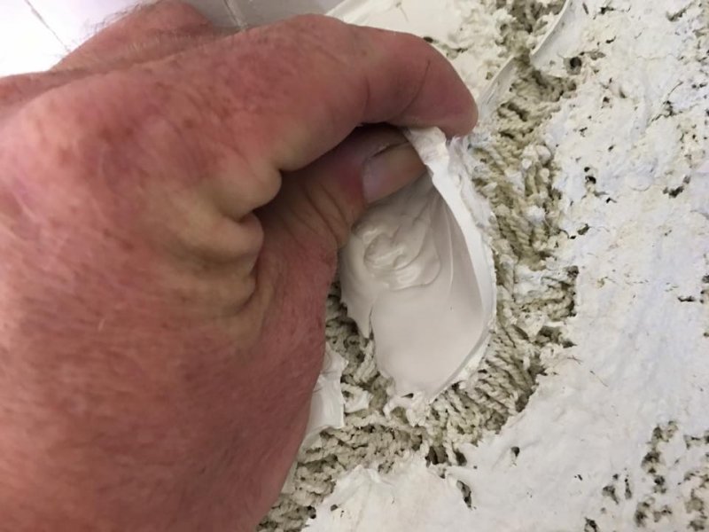

I walked from a paint Spill yesterday. Was dried as hard as a rock. I offered to replace the carpet but there was none to pull from. I sure wasn't going to spend hours getting that out.
