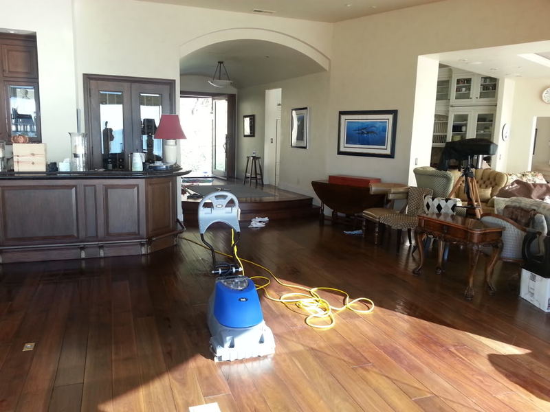

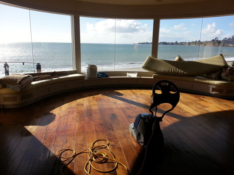

Mega 2nd home on the sand, gets tortured by the teenagers and big dogs on the weekends. One house cleaning lady is expected to keep the floors clean with just her Bona Mop.
We clean the wool carpets twice a year and this time the house manager asks if we know someone who could "really" clean the wood...
I have just the guy!....I rearranged the schedule to get us in today, move a ton of furniture but in four hours we got $950 for pushing the Dirt Dragon and a flat mop in the hard to reach areas, around.
No wear on the Vortex and just 9 ounces of a neutral pH cleaner..

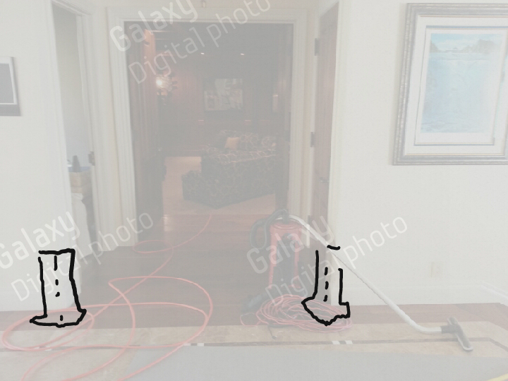

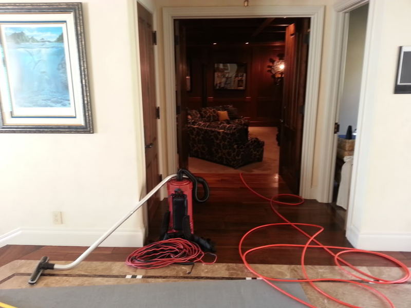

woops, I forgot the corner guards...

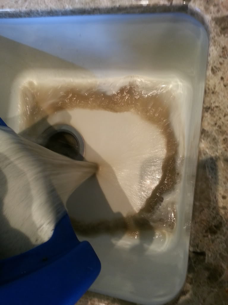

When I showed him what the maid left behind he took pics to send to the home owner.. (she just cleaned the wood floors prior to us getting there on Monday)
He stood by and made sure we did a good job.
