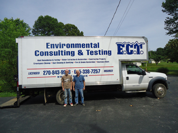

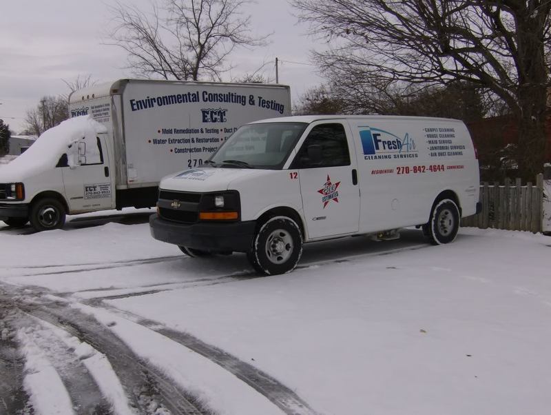

Pick up for sure. The vans are ok but have no power with loads. Get a ramp to
From this in the background to...
To..
