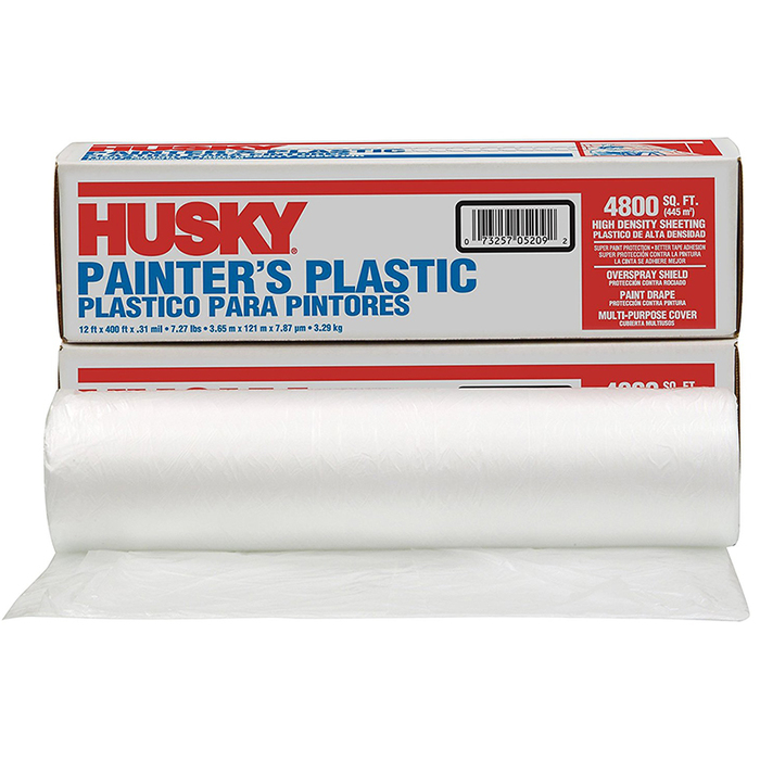

lay on paper poly drop cloth

if nowhere else to dry it leave it on the drop cloth

6 mil tucked around edges, airmover left while cleaning other rooms. Airmover left if included in the charge or multiple rugs cleaned.

Our techs clean rugs in the home constantly. So many customers would rather have it done that way, if there are not special circumstances (like urine or ink) Not sure how they pull it off, but they do! j/k, they are provided with good knowledge (often neutral detergent), know the importance of quick drying as well as retaining the original shape of the rug clean fringe well and provide protective paper during drying--much like Mikey does with his plastic sheeting. Rugs are fun! And profitable! just clean em well and dry em well.

That's one of the problems with in home cleaning, is the fringes. They are usually cotton and will brown with higher ph and over wetting. Good to see you are drying them.
