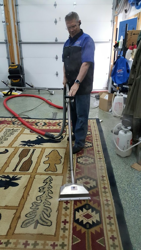

It was no big deal just use to getting and going. Crew was out before the wand came but had a small piece of cut pile nylon with dirt grease and oil on it. Had two guys try it when they returned.
While not on the job first thoughts
Weight: Very light the guys liked that. I thought chatter but there was not.
Jets: No over spray with the way it came
Glide: Worked fine first time we used a two piece. ( what is the cost to replace it. I think it will be one piece?)
Flushing: Excellent big surprise to be honest about it.
Drying: To many passes to really tell but did not see a problem. Next week will be a better test.
Length: The wand gripped the carpet at a different angle between the three of us because of different heights
Overall nice wand see how it does in the field next week.

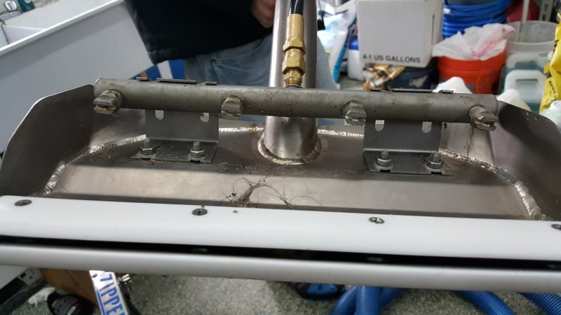

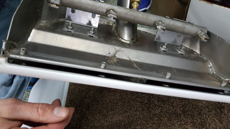

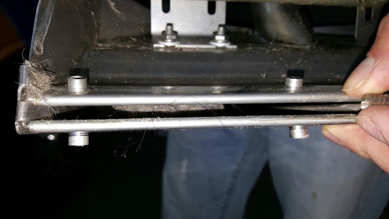

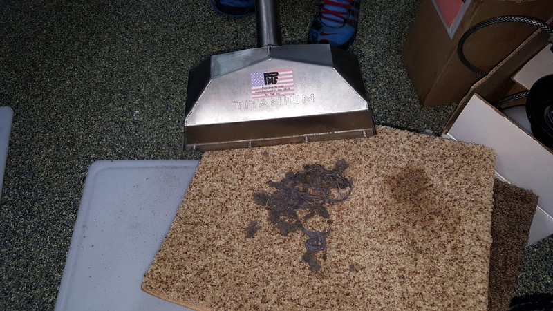

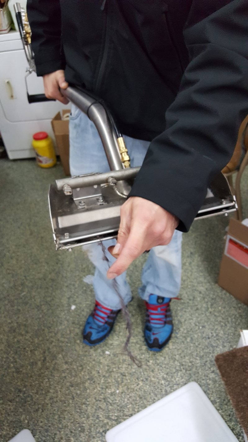

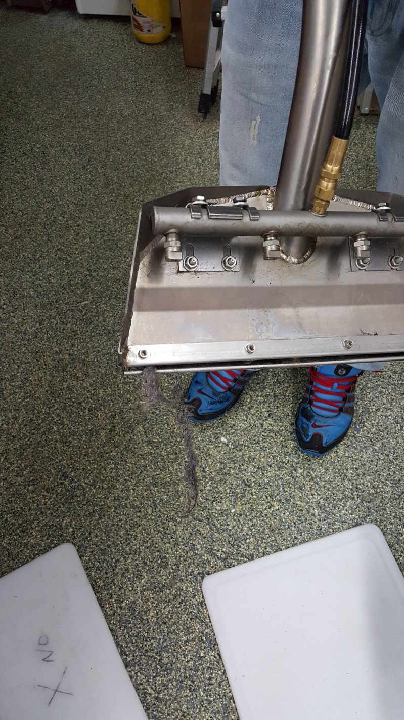

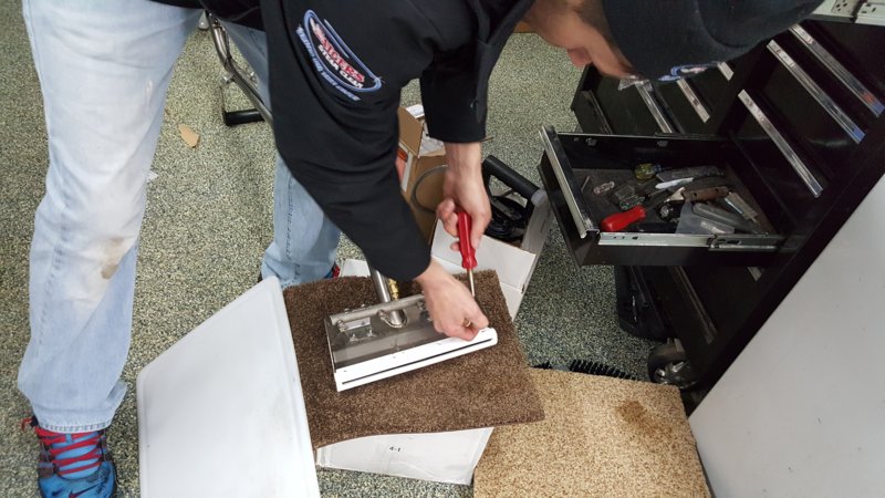

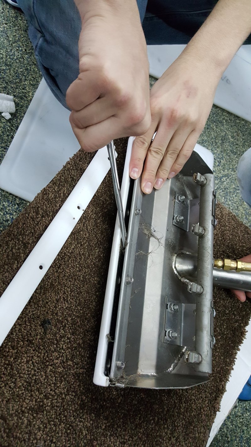

So David decided on not purchasing the Mach 12 because it left carpet too wet.
He liked everything else about it.
It was sent to Saiger who went to use it today and found out why David was having issues.
@Fred Boyle Boyle's vagina found its way into the head creating a 50% blockage....lol
MI7jwdqx3Eoo6Jvnnjdo5zSg0QiQlGTQbrGRyr4dp6dhlwsFn17XApsTV8WTsUe3t0zIjCqEksi4oOlB0A=w1769-h995-no.jpg
5x2tdJSoc5N032JgXy2XOlDC3ljK8zoEMsh6e5jYQdSiea9zzoDWcYiO7erFc9Ehx8RJboZFBvkhIJc7BQ=w1769-h995-no.jpg
VUmdf9d4BBw_B5i_Y9GBn-ZydZmbM5pVKX_f2llfvoX9JTmYyJTapoccBDUl3YW1AeME4ZR7hXTWeJmibSA=w560-h995-no.jpg
I'm wondering if those are Kentucky brand buttwads or from New Jersey..

Looks like it needs a little porting and polishing on the interior so the wand hamsters don't snag.
