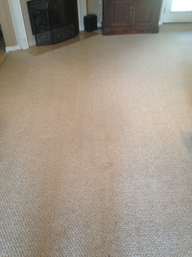

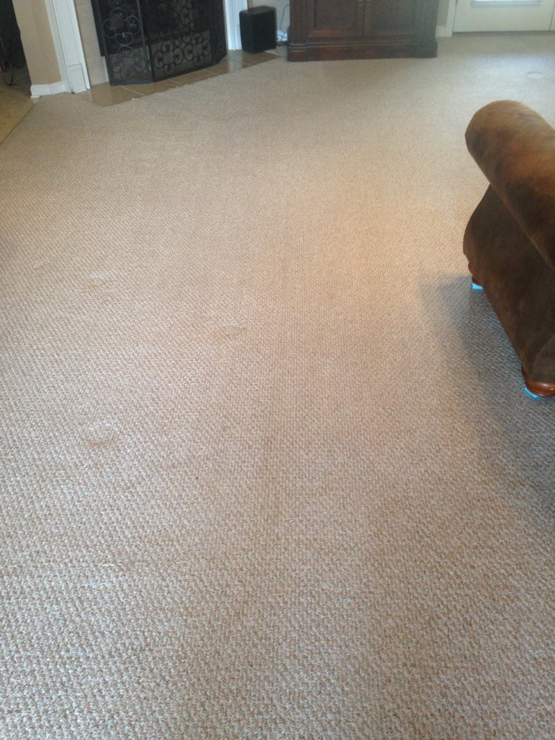

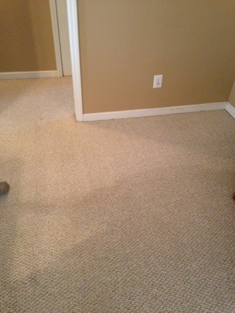

Mine came in today. I used it on two jobs. First thing I noticed, after noticing that Pembertons people don't know how to use Teflon tape, was how much air that thing seems to be moving. It sounds just like a two inch wand. Then I noticed it left the carpet just as dry ... it seems. I'll know more tomorrow. Mikey is wrong, it does overspray. Not as bad as my Greenglided wands do, but enough to notice . Look at these pics and see if you can see the streaks.
Those are not from clogged jets. It's wet streaks from overspray.

View attachment 11658 View attachment 11657 View attachment 11657 Mine came in today. I used it on two jobs. First thing I noticed, after noticing that Pembertons people don't know how to use Teflon tape, was how much air that thing seems to be moving. It sounds just like a two inch wand. Then I noticed it left the carpet just as dry ... it seems. I'll know more tomorrow. Mikey is wrong, it does overspray. Not as bad as my Greenglided wands do, but enough to notice . Look at these pics and see if you can see the streaks.

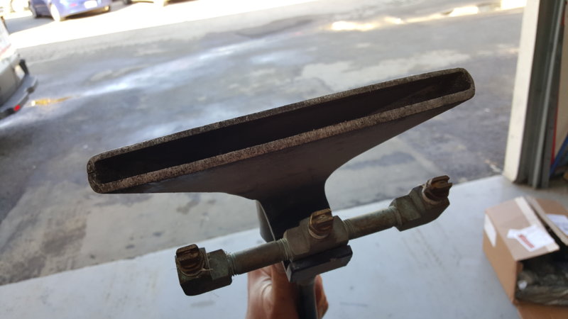

I have 1 inch extenders and 9502 on the ends of my prochem Ti with a holed glide. The spray pattern stays a 1/4 inch from the edge on both sides.
I suppose if you go real slow the flow could build up and flow beyond the width of the wand. Requiring dry strokes.
I always dry stroke anyways. But there are times I will do a slow back stroke on a mild to moderately soiled carpet.

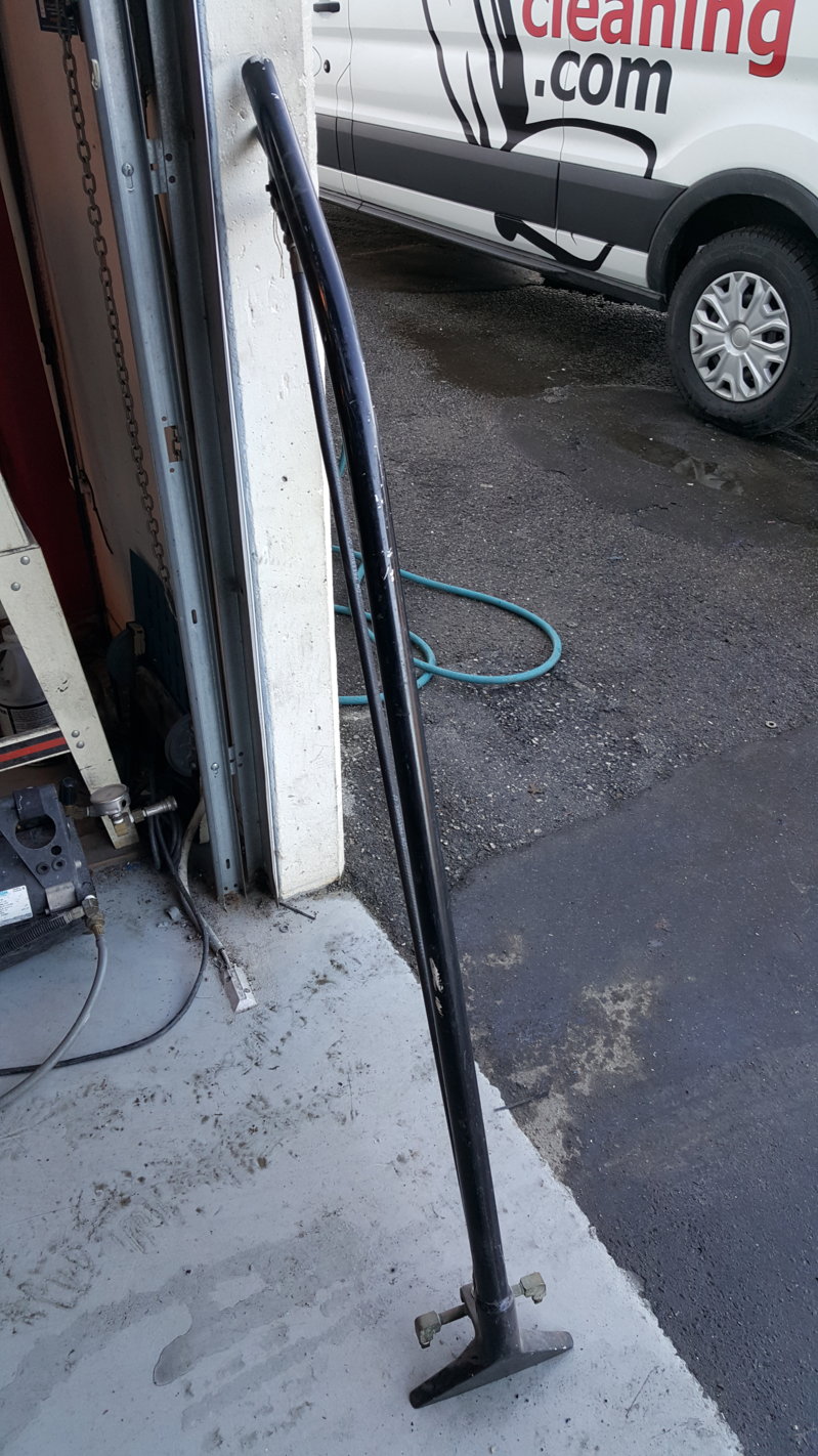

I tried to buy this baby off the hotel I was at the other day to give to @Jimmy L
But they were really attached to it...
And I did make a video while there... But just for Jimmy, I only put it on my YouTube channel for the carpet mill :)
Just showing some respect for my guys @hogjowl @Jimmy L

Mark my castex is the 16 inch one with 4 jets. I put a splash guard manifold on it and a better handle. People talk about superior airflow bla bla bla. But the way the head is designed as you can see is that it get wide at the top. Better airflow and because of the 16 inch width more air is allowed to flow . The width of the slot is also narrower so it glides better on carpet with those SS glides. It's about 23 years old now. I try all of the new wands and frankly there hasn't been much improvement over the years. Yeah you can say glides but they were made to cover up the design flaw of existing wands.
Their slots were too wide and sucked down on the carpet. My theory is wands were never meant to be pushed backwards and forwards, just pulled back.
