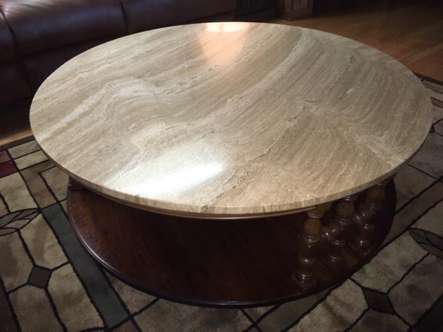

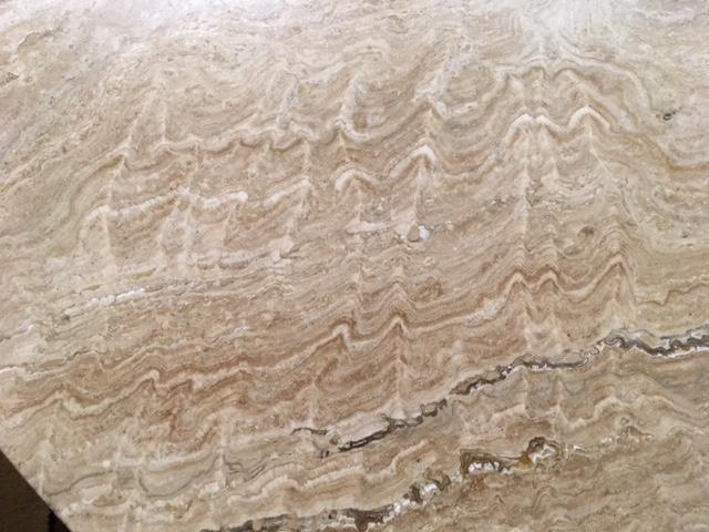

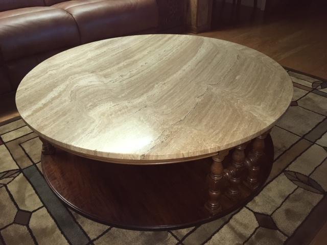

Thought maybe some of you would appreciate seeing the finished product. My Son and Daughter-in-Law had painted the table with white "Chalk Paint" because that was what was "Currently in style" I guess. Decorum prevents me from saying what it looked like to me. Naturally removing the paint also destroyed the original finish. I love natural/real wood, and want to see the grain. The stripping, re-staining, and finishing; with all the turned/grooved legs was a nightmare. It took WAY LONGER than the Travertine top. That is something I have always hated and avoided at all costs. If you offer me a job on a shovel, or a paint brush; ...I'll take the shovel. LOL These shots were taken finished and in my Den, which is kind of dark with mostly indirect lighting. I was surprised that removing only a few thousandths changed the color more to the cremes, instead of the browns, in the stone; and brought out patterns that were not seen before sanding. The close-up of the little "Squiggly Lines" pattern that resembles a child's handwriting exercise, was not visible before cutting down the surface. Wish I could have found something finer than 2500 grit just to see how shiny I could have made it. Many thanks again to all of you for your help, advice, and encouragement; ....especially to "Old Coastie" and "Mikey P".
