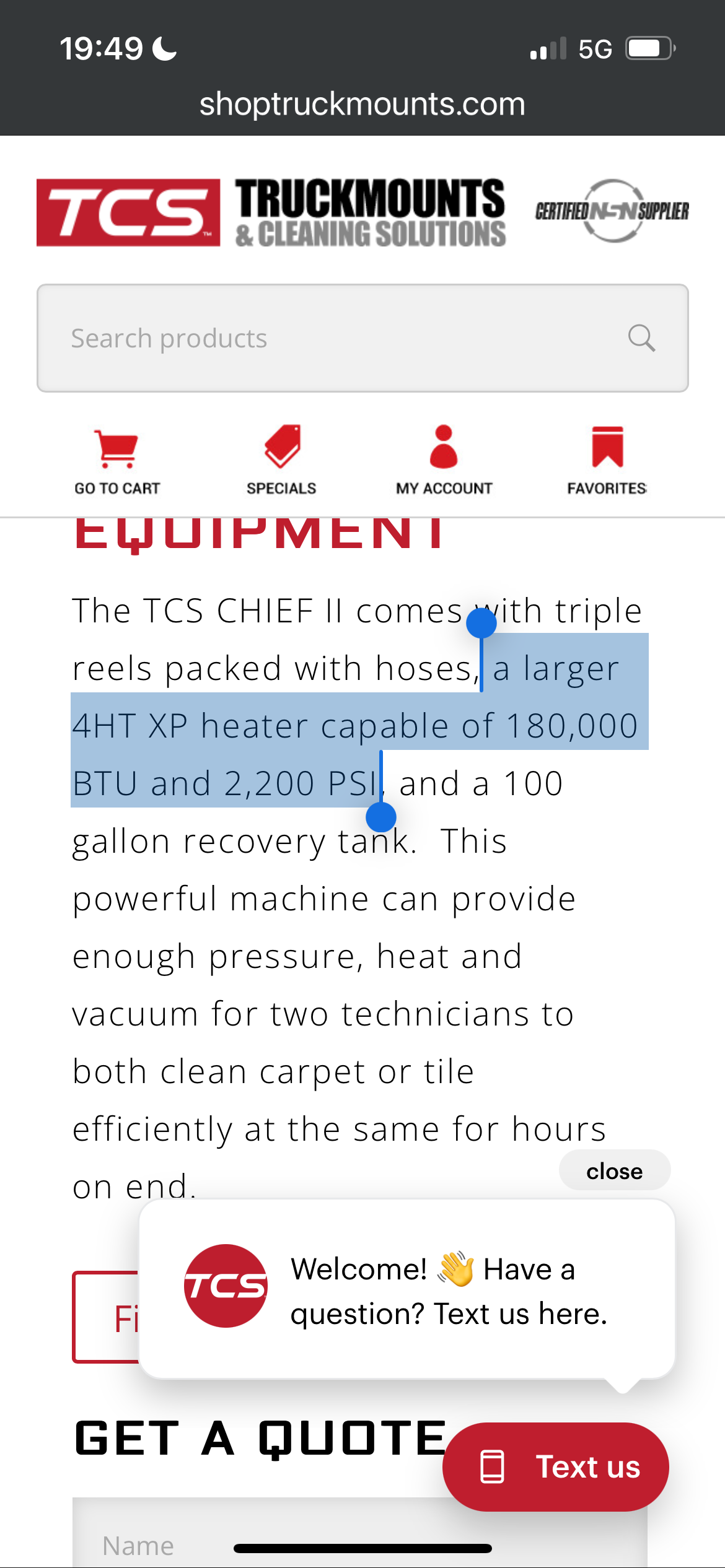

The pump is capable of 2000psi....which you won't need
I believe the 4ht extreme is included which is also good to 2000 psi.
You would be able to high pressure clean with heat

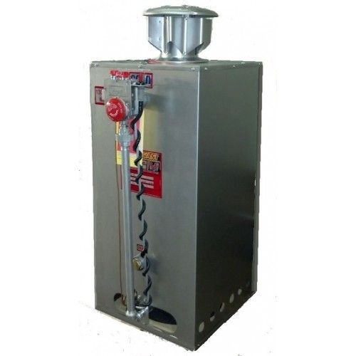

TCS heaters have a max pressure capacity of 800 psi.
Chief II has a 4ht “extreme”
4ht comes in high pressure 1000psi and extreme 2000psi
Looks like the 3ht has that option too
Reactions: alexcarpets

I’d like to think my complaining all these years made a difference. My Chief II’s couldn’t go over 800 psi. Cleaning tile at 800 psi sucks.
I will be looking at going with the "extreme" if I go with this unit. That said I have two questions:
1) First question sounds dumb, but it's a genuine question for someone new to the industry. The previous poster mentioned 800 psi's as the maximum pressure capacity of the heater. Does the heater not heat the water up, only? Or does it have a dual function of heating the water, and pressuring is it to go down the hose and to the wand?
2) The second question is with respect to the "Little Giant" Heater. It mentions, "3.75 GPM (60° Rise)1.87 GPM (120° Rise)". That would mean that standard garden hose water going into the tank, and then through the heater, with an initial temperature of 50F, would only get up to 110F (@ 3.75 gpm) and 170F (@ 1.87 gpm). Is that the temperature going down to the wand? That seems really low. I think I may have missed a step, or have misunderstood the concept?

1. The heater only heats the water but the coils/plumbing are rated to 2000 psi
2. The 4ht has plenty of heat. You are going to be using much closer to 1.25 gpm than 3.75 . And that is constant flow which you will seldom use. In normal use you will get higher temps up to the high temp limit of the heater.

Keep in mind that heat exchangers also suffer this drop as flow is increased to constant
