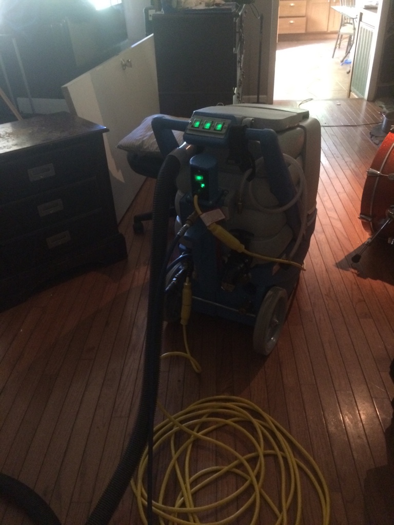

Here is a high rise haul.
If it's resi I use the vac to post groom.
Spotters on the machine and in the bucket.
