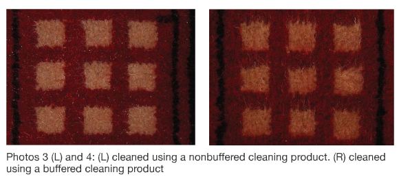

Once you buffer something it's very hard to reverse it. The buffering fights to keep there. I wouldn't use a buffered alkaline on a wool.
Gene

This photo from the IICRC Journal article on rinses
shows the effect on Wool dye of leaving the pH too high . . .
Reactions: J Scott W
