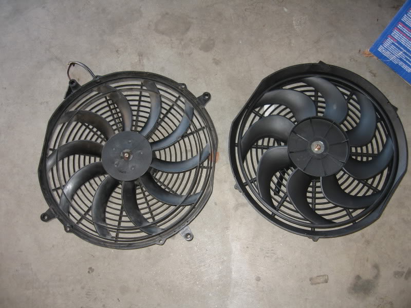

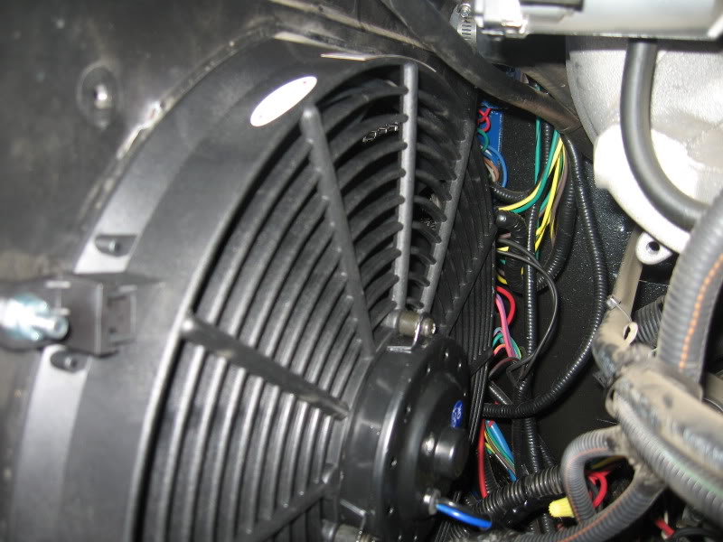

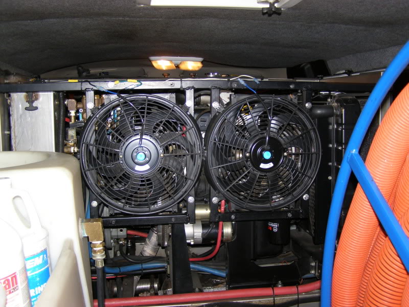

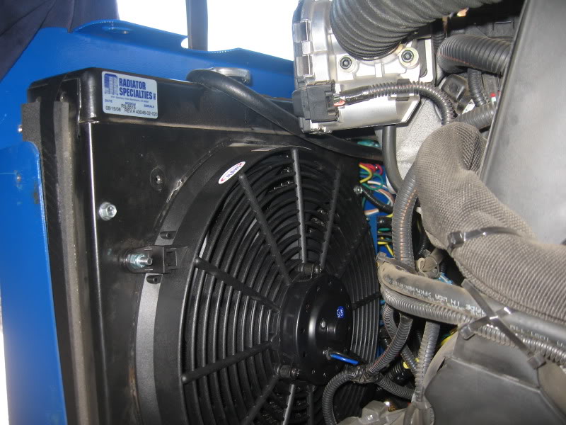

Jim Martin
Arizona
Jim Martin
I am thinking that heat is playing a part in this....things expand and contract when they get excessive heat...causing sporadic problems..... some components don't always react the same...and it makes it hard to figure out..
I applaude Olson for not wanting to put a part on and come to find out that it was not the problem and have to charge for it....I had a problem with my CDS unit and they just kept shooting in the dark and replacing parts and charging me for them and never fixed the problem...finally had to take it up to phoenix and get it fixed...
but this is a double edge sword....when it comes to a component like this the only way to be sure is to really replace it.......I fully understand where Olson is coming from...but if in fact it is not the unit...???????
not to sure that air flow is really his problem...but I know mine was shutting down because of this heat we have and there was not enough air being pushed threw the radiator and across the engine to keep it cool.....once I replaced the fan with one that gave me better air flow it has never happened again...
