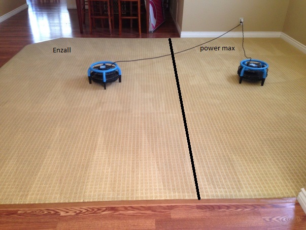

We sprayed facing the dresser to our right with prekleen to the left where you can see the bigger chocolate stain powermax. The dividing line is between the drawers in the dresser.
http://youtu.be/Ao5EsgWokBU
11,182
The photos were a picture of the 2 different products used and I just added the video sorry! and the prekleen side did look a little lighter.

For stains like chocolate, the oxidizer will continue to work after the initial extraction.
It would be best to photograph about 30 min. after extraction.
That is probably why the Olefin berber looked so good.

Prekleen contains NO oxidizer or D'imo and is a lower pH than Powermax so why would you say they are similar?
A more interesting comparison would have been with Enzall and PM
It does have de lemonine
Citrus terpenes read your label it doesn't have oxidizers and is a lower ph
11,182
Bad doggy! This time I sprayed 1/2 powermax and some KOP then spray enzall and KOP. Rinsed with all fiber rinse and cobbs brightner.
114,149
put down the bong and e edit your photos in Paint to show where the dividing line is and what side of the room each product was used on and wtf is KOP?

So if I understand you added some oxidizer to your all fab rinse thru your TM?
11,182
kill odor plus and I believe its 40 volume peroxide its a liquid I add a cup into the rinse.
