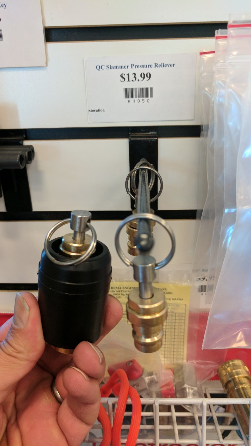

Pressure relief popper...
117,378
Would you buy this?
I should think a PR valve belongs outside on the truck, vented downward.

No. I use male QD on the business end of the hose. If there is pressure in the line tap it on the wand and you are good to go.
Reactions: Mark Saiger
Only time it would be helpful is when the helper tried to connect the wand and wasn't seated properly-so now ther is pressure between the shutoff valve and the quick connect poppet.
Here lies the problem with the pop off slammer unit.
You have to go to the truck to get the pressurepopper thingy so you might as well just open your regulator and connect the tool.
Would be nice on bigger jobs when switching from hydroforce to tool and vice versa if someone doesn't get the quick connect seated properly as it would save time from running to truck back and forth.
So you would just take it in with the spotters and need as needed..
Now I will be buying a couple.
Reactions: Steve Lawrence
Use a ball valve and hope said chimp doesn't pressurize the line while it's not seated.
Because if he does? I don't think you'll be able to attach this relief thingy either with out running to the truck to depresurrize.
That is the purpose of this thing!
Otherwise it has no purpose.
I imagine the middle stem hits the qds poppet reliving the bit of volume of pressure it has as ling as The valve is closed and has no blow by.
