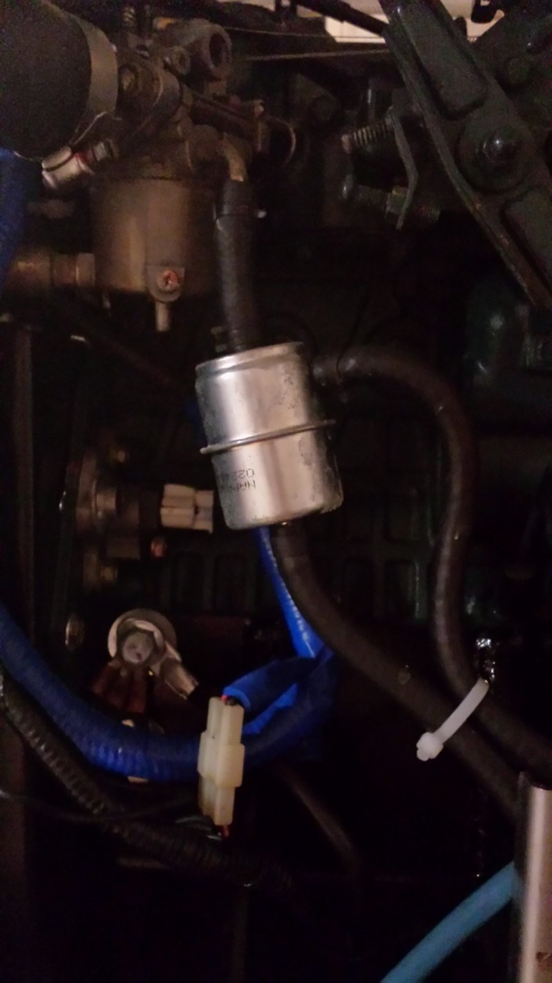

Napa has a filter that is a bypass filter. It will keep cycling fresh fuel back to the tank so you shouldnt get that vapor lock from the heat. I've gotten that sometimes as well.
Able 1
Apr 12, 2008
6,469
Wi
Keith
Yeah this one..
