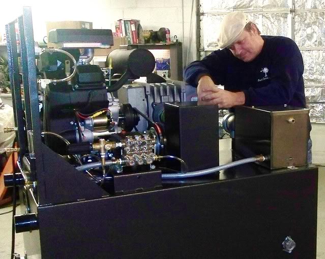

I wonder if the new Sapphire Scientific 870SS is any less complicated than the Everest? They call it "The ultimate three-wand unit".
And it has a MD Pneumatics 5009....850 CFM Blower....
There are a few out here in the Phoenix market now.
Allen Equipment is selling them.
